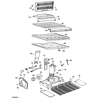

The Light Switch is an OEM replacement part for GE refrigerators. It controls the interior light, turning it on when the refrigerator door is opened and off when the door is closed. This ensures proper illumination for visibility when accessing the refrigerator's contents.
A malfunctioning light switch can result from wear and tear, electrical issues, or damage caused by repeated use. Over time, the internal mechanism may fail, or the housing can crack, leading to improper operation.
Symptoms of a bad light switch include:
  • Interior light not turning on when the door is opened
  • Light staying on even when the door is closed
  • Flickering or inconsistent light operation
  • Difficulty pressing or releasing the switch

The defrost heater warms the evaporator during automatic defrost cycles to remove frost and ice, restoring airflow and cooling. Replacing a failed heater helps prevent frost buildup and maintain more consistent temperatures throughout the refrigerator.
  • Melts frost from the evaporator coil during scheduled defrost cycles
  • Helps maintain airflow and cooling performance between compartments
  • Failure may cause heavy frost on the back wall/evaporator cover
  • Can lead to reduced cooling, long run times, or fan noise from ice contact
What's included: One defrost heater. Install notes:
  • Disconnect power before servicing; wear appropriate gloves.
  • Remove freezer shelves/ice maker as needed and the rear panel to access the evaporator area.
  • Defrost any ice buildup and avoid damaging evaporator fins or wiring.
  • Reuse original mounting hardware/clips as needed; check the defrost thermostat and control if frost issues continue.

This trough drain collects and channels defrost and condensation water from the evaporator area to the drain system, helping prevent leaks and pooling inside the refrigerator. It restores proper water flow and reduces standing water. What it does:
  • Collects defrost/condensation runoff from the evaporator area and directs it to the drain pan.
  • Helps prevent water pooling inside the fridge or under crisper drawers.
  • Reduces ice buildup and musty odors caused by trapped moisture.
  • Replaces cracked or warped troughs that allow leaks or improper drainage.
What's included: One trough drain. Install notes:
  • Remove food, shelves and the evaporator cover/pan as required for access; follow the service manual for your model.
  • Clean the drain tube and drain hole before installing to ensure proper drainage.

This cable clamp secures refrigerator wiring to the cabinet, keeping harnesses organized and protected. Replacing a missing or damaged clamp helps prevent chafing and vibration noise while maintaining proper clearance from fans and other moving components.
  • Anchors wire harnesses in their designed routing
  • Helps prevent insulation wear from rubbing or vibration
  • Keeps wires clear of sharp edges and moving parts
  • Common signs it's needed: missing/broken clamp, loose or dangling wires, or new rattling/buzzing noises
What's included: 1 cable clamp Install notes:
  • Access the clamp location and note original wire routing
  • Position the clamp and secure with the existing fastener; do not overtighten
  • Ensure wires aren't pinched and have clearance from the fan/compressor before restoring power

This power cord assembly supplies electrical power from the wall outlet to your refrigerator. Replace a cut, frayed, or overheated cord to restore safe, reliable operation and eliminate intermittent power loss caused by a damaged cord. What it does:
  • Provides the electrical connection between the household outlet and the refrigerator's wiring
  • Helps resolve no-power or intermittent power when the cord is moved
  • Addresses visible damage such as cuts, cracks, fraying, or a melted/discolored plug
  • Mitigates arcing, sparking, or a burning odor originating from the cord or plug area
  • One power cord assembly
  • Disconnect power by unplugging the unit or switching off the circuit breaker before servicing
  • Pull the refrigerator forward for access; note the original cord routing and connections
  • Install the new cord along the same path and secure any built-in strain relief; ensure the ground connection is properly seated
  • Restore power and verify operation

The Condenser Fan Motor is an OEM part for GE refrigerators. It is designed to circulate air through the condenser coils, helping to dissipate heat and keep the refrigerator's internal components cool. This ensures efficient operation and prevents the compressor from overheating, which is essential for maintaining the refrigerator's performance and longevity.
You should replace the condenser fan motor if it becomes faulty. Causes of a bad fan motor can include electrical failures, wear and tear from regular use, or blockages that cause the motor to overheat or burn out. A malfunctioning fan motor can lead to inadequate cooling, increased energy consumption, and potential damage to other refrigerator components.
Symptoms of a bad condenser fan motor include:
  • The refrigerator not cooling properly
  • Unusual noises coming from the back of the refrigerator
  • The compressor running hot or cycling on and off frequently
  • The condenser coils feeling excessively hot

A replacement motor start/run capacitor that helps restore reliable motor starting and smooth operation for compressors and fans. Installing the correct capacitor can reduce hard-starts, humming and intermittent motor operation. What it does:
  • Provides the temporary boost motors need to start and stabilize while running.
  • Helps compressors and fan motors start more easily and run more efficiently.
  • Commonly associated with symptoms like humming, motors that won't start, intermittent operation, or reduced cooling performance.
  • Prevents repeated motor stress that can lead to overload trips or premature motor wear.
What's included: One capacitor Install notes:
  • Disconnect power to the appliance before accessing electrical components.
  • Discharge the capacitor and tag/photograph wire locations before removal to ensure correct reinstallation.
  • Replace with the exact OEM part or an approved equivalent; do not bend or puncture the capacitor can.

The Start Relay is an OEM part for GE refrigerators. It helps initiate the compressor by providing a temporary boost of power to start the cooling process.
Causes of a bad start relay can include electrical failures, overheating, or general wear and tear.
Symptoms of a bad start relay include:
  • The compressor failing to start
  • Clicking noises coming from the compressor area
