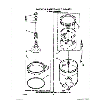

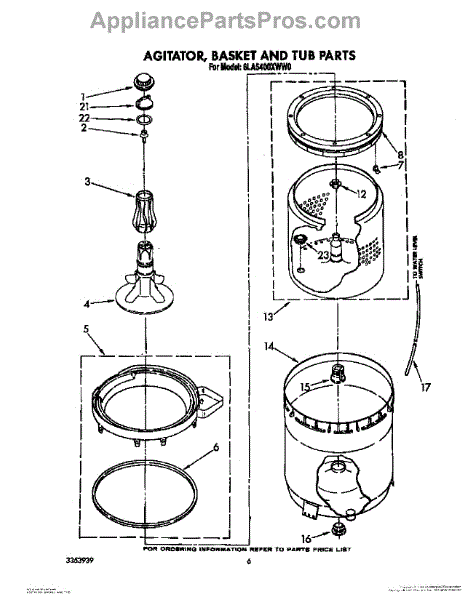

Parts for Whirlpool 6LA5400XWF0: 04 - Agitator, Basket And Tub Parts
