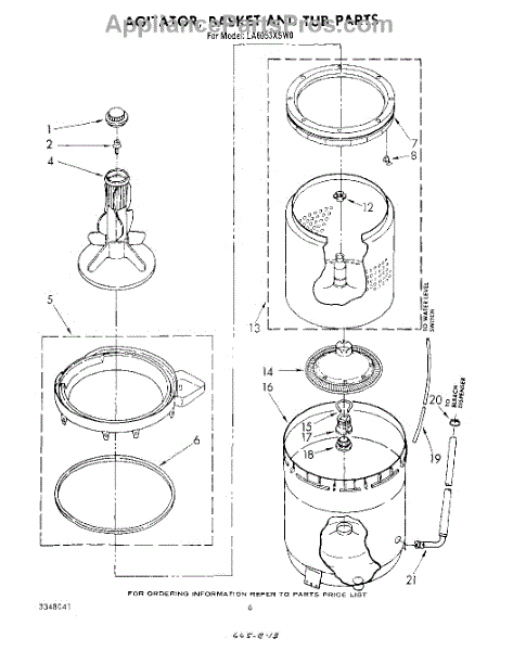

Parts for Whirlpool LA6053XSW0: 05 - Agitator, Basket And Tub Parts
