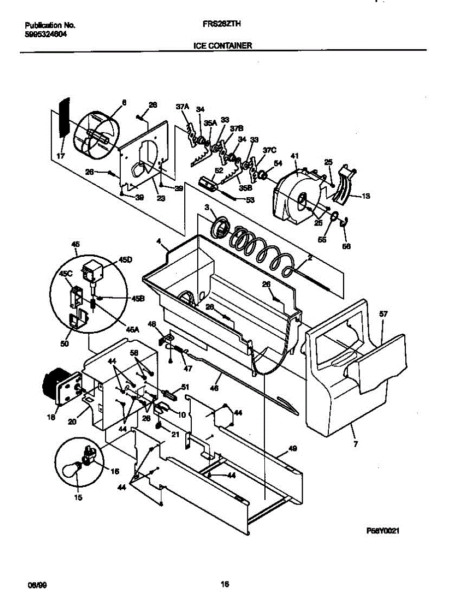

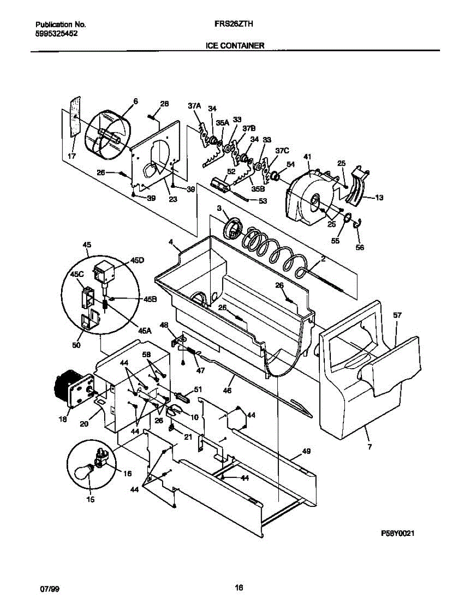

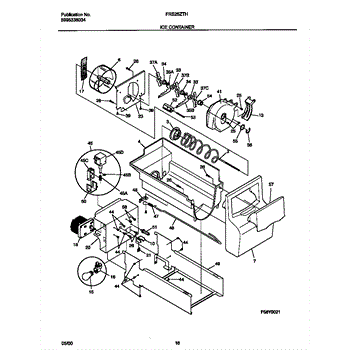

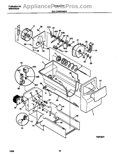

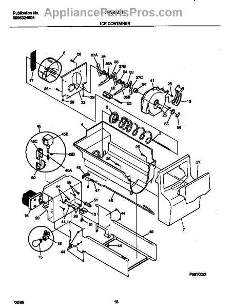

Parts for Frigidaire FRS26ZTHW0: 09 - Ice Container Parts
