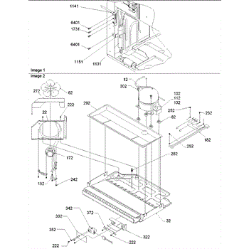

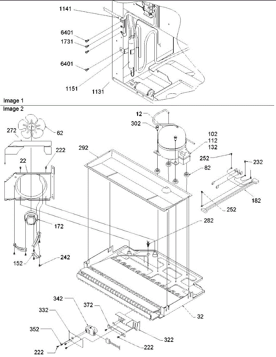

This is the refrigerator's sealed-system compressor. It pressurizes and moves refrigerant through the system to remove heat from the cabinet, restoring consistent cooling performance when the original compressor has failed or lost capacity. What it does and common symptoms:
  • Pumps and circulates refrigerant through the evaporator and condenser to remove heat
  • Maintains target temperatures in both fresh food and freezer sections
  • Symptoms of failure can include: no cool/poor cooling, unit warms up after short operation, humming then clicking from the compressor area, or repeated thermal overload trips
  • Runs but not cool effectively when the compressor is weak or internally damaged (after ruling out start components and charge issues)
  • 1 compressor
  • Disconnect power before servicing; sealed-system work involves high pressure and high temperatures
  • Sealed-system repairs require EPA Section 608 certification and specialized tools (gauges, vacuum pump, brazing equipment)
  • Replace the filter-drier, braze connections properly, evacuate to deep vacuum, and charge to the model's specification
  • Related components (start device/overload, run capacitor, controls) are tested before condemning the compressor

This grommet is a small protective seal used where a hose, tube, wire, or component passes through or mounts to the appliance cabinet. It cushions the connection and helps prevent leaks, vibration, and wear for reliable operation.
  • Provides a snug barrier between parts and metal openings to protect hoses, tubes, and wiring
  • Helps seal against moisture to reduce seepage
  • Dampens vibration and rattling noises
  • Replace if cracked, hardened, missing, or no longer stays seated; symptoms may include drips at a pass-through, buzzing/rattling, or a loose fit
What's included: 1 grommet
  • Access the grommet location and note orientation/routing
  • Remove the old grommet and clean the opening
  • Press the new grommet fully into place; reassemble and test for leaks/noise

The Relay and Overload is an OEM replacement part for Whirlpool refrigerators. These electronic components regulate key refrigerator operations and safety measures. The relay controls the start and stop of refrigeration components like the compressor and condenser fan motor.
Symptoms of a bad relay and overload include:
  • Refrigerator failing to consistently cool or maintain temperature
  • Buzzing or humming noises coming from cooling areas
  • Tripped circuit breakers
Causes can include defective relay contacts, a burned-out overload, or worn-out electrical components internal to either part.
This OEM Whirlpool replacement is also compatible with Maytag, KitchenAid, Jenn-Air, Amana, Magic Chef, and select Kenmore fridge models as well.

The Run Capacitor is an OEM part for Whirlpool refrigerators. It is responsible for helping the compressor motor start and run efficiently by providing an extra electrical boost. This component ensures that the refrigerator operates smoothly and maintains the correct temperature by stabilizing the compressor's performance.
Causes of a bad run capacitor can include electrical surges, age-related wear, or overheating. When the capacitor fails, the compressor may struggle to start or run continuously, leading to inefficient cooling or a non-functional refrigerator.
Symptoms of a bad run capacitor include:
  • The refrigerator not cooling properly
  • The compressor not starting or running intermittently
  • Unusual clicking noises from the refrigerator

This OEM Replacement Part is a high-quality, 2-watt condenser fan motor for Whirlpool refrigerators.The motor is designed to optimize your refrigerator's cooling performance. This 115-volt motor operates with a clockwise rotation.
Symptoms of a bad condenser fan motor kit include:
  • Gradual rise in interior freezer temperatures
  • Inability to maintain consistent cooling performance
  • Loud buzzing or grinding noises coming from inside
  • Tripped breakers or failure to restart after service
Causes stem from normal wear of ball bearings as the high-efficiency motor operates continuously. Exposure to dust or debris introduced through openings accelerates wear over many years of use.
This OEM part is also compatible with brands including Kenmore, KitchenAid, and Danby.

The Refrigerator Defrost Timer is an OEM Replacement Part designed to manage the automatic defrost system in Whirlpool freezers. Housed at the top inside of the appliance, this component shuts off the cooling system and activates the defrost heater. The timer operates at 120V 60Hz and activates for 33 minutes every 8 hours. The dial on the timer can be turned clockwise to advance it into and out of defrost.
Causes of a faulty Defrost Timer Kit can include electrical issues, mechanical wear and tear over time, or problems with the timer's internal components.
Symptoms of a bad Defrost Timer Kit include:
  • Freezer not defrosting properly, leading to excessive ice buildup
  • Refrigerator running constantly or not cooling effectively
  • Condensation or moisture issues inside the refrigerator
  • Error codes related to the defrost system

This drier is the factory replacement air/gas flow assembly that helps maintain proper airflow and drying performance in compatible laundry dryers. Replacing a worn drier restores consistent drying and reduces overheating risk. What it does:
  • Directs and stabilizes heated air through the drum for efficient drying
  • Helps prevent restricted airflow that can cause long dry times or damp laundry
  • Supports safe exhaust flow to reduce the chance of overheating or lint buildup
  • Works with the dryer's heating and ventilation components to maintain normal operation
  • One drier assembly as shown
  • Disconnect electrical power before beginning service; if this is a gas dryer, turn off and disconnect the gas supply
  • Follow the dryer manufacturer's service manual for disassembly and reassembly steps
  • Use appropriate hand tools and avoid forcing parts; inspect venting and lint traps while replacing
