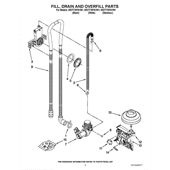

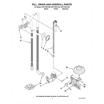

Parts for Whirlpool WDT710PAYW6: 05 - Fill, Drain And Overfill Parts
