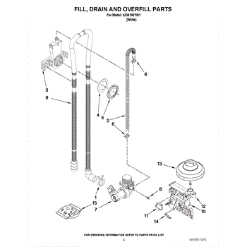

The Fill Hose is an OEM part for Whirlpool dishwashers. This hose is responsible for delivering water from your home’s water supply to the dishwasher during the wash cycles. It ensures that the appliance receives the necessary amount of water to clean dishes effectively.
Over time, the fill hose can become damaged due to wear and tear, exposure to high water pressure, or kinks and bends that restrict water flow. If the hose is compromised, it can lead to water supply issues or leaks, impacting the dishwasher’s performance.
Symptoms of a bad fill hose include:
  • Water not entering the dishwasher
  • Leaks or puddles around or under the dishwasher
  • Error codes related to water supply issues
  • Visible cracks, kinks, or damage to the hose

The Inlet Assembly is an OEM part for Whirlpool dishwashers. It is responsible for controlling the flow of water into the dishwasher during the wash cycle. This assembly ensures that the correct amount of water enters the dishwasher to clean dishes effectively.
You should replace the inlet assembly if it becomes faulty. Causes of a bad inlet assembly can include wear and tear from regular use, blockages from debris or mineral buildup, or electrical issues. A malfunctioning inlet assembly can lead to inadequate water flow, which affects the dishwasher’s cleaning performance.
Symptoms of a bad inlet assembly include:
  • The dishwasher not filling with water or filling slowly
  • Water leaks around the inlet area
  • Error codes related to water intake issues
  • The dishwasher stopping mid-cycle or not starting

The Tub Inlet Gasket is an OEM part for Whirlpool dishwashers. It ensures a watertight seal at the point where water enters the tub, preventing leaks and maintaining efficient water flow during the wash cycle.
Causes of a bad tub inlet gasket include wear and tear from regular use, damage from harsh cleaning chemicals, or drying out and cracking due to age.
Symptoms of a bad tub inlet gasket include:
  • Water leaking from the front or bottom of the dishwasher
  • Poor cleaning results due to insufficient water pressure
  • Visible cracks or wear on the gasket
  • Unusual noises from the dishwasher during the filling cycle

This tube nut secures the water inlet tubing to its fitting, creating a tight, leak-resistant connection. Use it when the original nut is cracked, stripped, or can no longer hold the line securely.
  • Tightens over the inlet fitting to clamp the water tube and form a reliable seal
  • Helps stop drips at the water-line connection point
  • Addresses loose or damaged inlet connections and difficulty keeping the tube seated
  • Commonly replaced when the nut is worn, cross-threaded, or visibly cracked
What's included: 1 tube nut Install notes:
  • Place a towel to catch residual water and relieve line pressure
  • Hold the fitting with one wrench while tightening the nut with another to avoid twisting components
  • Do not overtighten; restore water and check for leaks after installation
  • Inspect the tubing, ferrule/sleeve, and insert; replace if worn or damaged

The Water Inlet Valve is an OEM part for Whirlpool dishwashers. It regulates the flow of water into the machine. This valve opens and closes to allow the right amount of water in during various cycles, ensuring dishes are cleaned effectively without wasting water.
Over time, the water inlet valve can fail due to mineral buildup from hard water, wear and tear from frequent use, or mechanical failure of the valve components. A malfunctioning valve can lead to problems such as insufficient water entering the dishwasher, leading to poorly cleaned dishes, or leaking, which can cause water damage over time.
Symptoms of a bad Water Inlet Valve include:
  • Dishwasher not filling with water
  • Water filling too slowly or overfilling
  • Unusual noises during the fill cycle
  • Leaks around the dishwasher

The Drain Hose is an OEM part for Whirlpool dishwashers. It is designed to transport wastewater from the dishwasher to the household drain system, ensuring efficient and safe removal of water after each wash cycle. This drain hose is 67” long and includes the check valve.
Symptoms of a bad Drain Hose include:
  • Water leaking from underneath or behind the dishwasher.
  • Signs of water damage or mold near the appliance, indicating persistent dampness.
  • Poor draining performance, with water remaining in the dishwasher after cycles.
Causes of a bad drain hose can include physical damage such as cracks or holes, clogging from food particles or grease, or improper connections that lead to leaks or kinks in the hose.

The Water Level Switch is an OEM part for Whirlpool dishwashers. It monitors and regulates the water level inside the dishwasher during wash cycles, ensuring the correct amount of water is used for optimal cleaning performance.
The water level switch can fail due to several reasons, such as electrical issues, mechanical wear over time, or damage from water exposure. Blockages or debris can also interfere with its proper functioning.
Symptoms of a bad water level switch include:
  • Overfilling or flooding inside the dishwasher
  • The dishwasher stopping mid-cycle or not progressing through cycles
  • Error codes related to water levels

This overfill protector housing mounts in the dishwasher tub floor to guide the overfill float and position the switch actuator. Replacing a damaged housing helps stop leaks at the float opening and restores proper overfill protection.
  • Guides the overfill float at the tub floor so it moves freely
  • Allows the float to engage the overfill switch and stop water fill at high level
  • Restores proper fit if the original housing is cracked, warped, or missing
  • Typical symptoms include leaking near the float, overfilling, or inconsistent fill levels
What's included: 1 overfill protector housing
  • Disconnect power and shut off water supply before servicing
  • Remove the toe panel and lower rack to access the float area
  • You may need to lift out the float and remove the under-tub switch bracket to replace the housing; note part orientation
  • After reassembly, run a brief fill and check for leaks at the float opening

This float assembly sits in the dishwasher tub and rises with incoming water to signal the float switch to stop filling. Replacing a worn or sticking overfill protector restores proper water level control and helps prevent overfilling and leaks.
  • Monitors water level by floating upward as the tub fills
  • Triggers the float switch to shut off the inlet valve at the correct level
  • Helps prevent overfilling and potential leaks
  • Helps with: won't fill or stops filling early, water level too high, float sticks or is visibly damaged
What's included: 1 float assembly Install notes:
  • Disconnect power and shut off the water supply before servicing.
  • Remove the lower rack to access the float inside the tub.
  • Lift the old float straight up; on some models a retainer under the tub must be released to remove it.
  • Transfer any existing hardware if needed, install the new float, ensure free movement, then restore power and test for proper fill.

The Water Level Float Lever is an OEM part for Whirlpool dishwashers. This lever is connected to the water level float, which monitors and regulates the water level inside the dishwasher. It ensures that the correct amount of water is used during the wash cycle, preventing overflows and maintaining optimal washing performance.
Common causes of a bad float lever include wear and tear, accumulation of food particles or mineral deposits, and physical damage from improper handling.
Symptoms of a bad water level float lever include:
  • The dishwasher overfilling and causing leaks
  • Inconsistent water levels during wash cycles
  • Error codes related to water level issues
This OEM part is also compatible with some Maytag, KitchenAid, Jenn-Air, Amana, Magic Chef, Admiral, Norge, Roper, and Kenmore models.
Includes two screws, two clamps, and undercounter mounting brackets.
