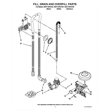

Parts for Whirlpool WDT710PAYM1: 04 - Fill, Drain And Overfill Parts

The Fill Hose is an OEM part for Whirlpool dishwashers. This hose is responsible for delivering water from your home’s water supply to the dishwasher during the wash cycles. It ensures that the appliance receives the necessary amount of water to clean dishes effectively.
Over time, the fill hose can become damaged due to wear and tear, exposure to high water pressure, or kinks and bends that restrict water flow. If the hose is compromised, it can lead to water supply issues or leaks, impacting the dishwasher’s performance.
Symptoms of a bad fill hose include:
  • Water not entering the dishwasher
  • Leaks or puddles around or under the dishwasher
  • Error codes related to water supply issues
  • Visible cracks, kinks, or damage to the hose
