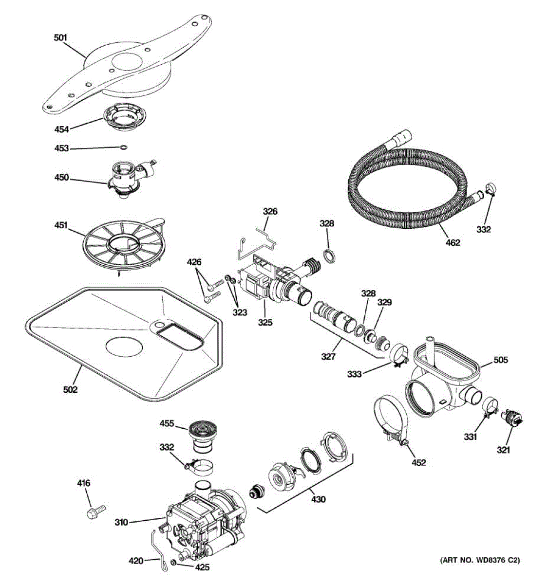

The Pump and Motor Assembly is an OEM replacement part for GE dishwashers. It works to circulate water throughout wash and rinse cycles. The motor spins the integrated pump impeller to draw fresh water into the dishwasher and drain used water.
Causes of a bad pump and motor assembly can include mineral buildup on pump parts inhibiting water flow, worn motor windings reducing efficiency, or damage from freezing temperatures.
Symptoms of a bad pump and motor assembly include:
  • Inability to fill or drain water from the dishwasher
  • Abnormal noises coming from the motor area
  • Leaks or water not circulating properly
This OEM part is also compatible with Hotpoint, RCA, and some Kenmore models.

This turbidity sensor monitors wash water clarity so the machine can adjust wash cycles and rinse times for cleaner results and efficient water use. It replaces a failed or inconsistent turbidity reading to restore proper load sensing. What it does:
  • Detects soil level/turbidity in wash water so the washer adapts cycle length and rinse actions
  • Helps prevent over- or under-washing by feeding water-quality signals to the control board
  • Commonly replaces units that cause long or short cycles, poor cleaning, or error codes related to wash sensing
What's included: One turbidity sensor Install notes:
  • Disconnect power before replacing to avoid shock or damage to electronics
  • Handle the sensor and connectors carefully; avoid contaminating sensing surfaces
  • Verify connector orientation and secure mounting; test a short cycle after installation

The Drain Pump Kit is an OEM part for GE dishwashers. Containing both the drain pump and float switch, it works together to remove water from the tub at the end of each cycle.
Symptoms of a bad Drain Pump Kit include:
  • Water remaining in the bottom of the tub after cycles complete
  • The dishwasher failed to drain properly
  • Strange noises or vibrations coming from the drain pump area
  • Float switch malfunction causing issues with cycle progression
Causes can include a worn-out or failing pump motor, clogged or obstructed pump impellers, or issues with the float switch mechanism.

The Circulation Pump Impeller Kit is an OEM replacement part for GE dishwashers. This kit includes the necessary impeller components responsible for circulating water throughout dishwashing cycles.
Causes of a bad circulation pump assembly include normal wear from continuous pump operation, along with mineral or debris buildup that can affect water flow.
Symptoms include:
  • Inadequate or lack of water circulation within cycles
  • Dirty dishes even after full cycles due to insufficient cleaning
This OEM GE part is compatible with some Hotpoint, RCA, and select Kenmore models.

The Fine Filter is an OEM part for GE dishwashers. It is designed to trap food particles and debris during the wash cycle, preventing them from recirculating onto the dishes and ensuring clean, spotless results.
Causes of a bad fine filter can include clogs from food particles, damage from sharp objects, or wear and tear over time. A compromised filter can lead to poor cleaning performance and potentially damage other components by allowing debris to circulate.
Symptoms of a bad Fine Filter include:
  • Poor cleaning results with food particles left on dishes
  • Increased noise during operation
  • Water drainage issues
  • Visible damage or clogging in the filter

The Fine Filter Hub Nut is an OEM part for GE dishwashers. It secures the fine filter in place, ensuring that debris and food particles are effectively filtered out during the wash cycle, preventing them from re-entering the dishwasher tub.
Causes of a bad fine filter hub nut can include wear and tear from regular use, damage from over-tightening, or cracking due to impact. A faulty hub nut can lead to improper filtration, causing debris to circulate and potentially clog the dishwasher.
Symptoms of a bad Fine Filter Hub Nut include:
  • Unusual noises during the wash cycle
  • The filter becoming loose or not staying in place

The Pump Connector is an OEM part for GE dishwashers. This connector joins the dishwasher’s pump to the drain hose, facilitating the proper expulsion of water during the draining cycle. It ensures a secure and leak-free connection, essential for the efficient operation of the dishwasher.
Over time, the pump connector can become compromised due to wear and tear, exposure to detergents and hot water, or damage from debris. If the connector fails, it can lead to leaks and drainage issues, impacting the dishwasher's performance.
Symptoms of a bad pump connector include:
  • Water leaking from the bottom of the dishwasher
  • Slow or incomplete drainage
  • Puddles of water around the dishwasher
  • Error codes related to drainage problems

The Drain Hose Kit is an OEM replacement part for GE built-in dishwasher models. It includes flexible tubing and attachments responsible for draining used water from the wash chamber via the internal pump outlet.
Symptoms of a bad drain hose include:
  • Puddles or standing water left inside after cycles complete
  • Slower overall wash and dry times from impaired drainage
  • Nosier pump operation potentially from hose blockages
Causes of failure can stem from cracking over extended usage years, or mineral buildup restricting flow.
This OEM replacement is also compatible with Electrolux, Gibson, Kelvinator, and some Kenmore refrigerators.

The Lower Spray Arm Assembly is an OEM part for GE dishwashers. This part is responsible for spraying water and detergent onto the lower rack of dishes during the wash cycle.
Causes of a bad Lower Spray Arm Assembly can include mineral buildup or debris clogging the spray holes, physical damage from impact or foreign objects, or wear and tear over time.
Symptoms of a faulty Lower Spray Arm Assembly include:
  • Incomplete or ineffective washing of dishes on the lower rack
  • Water not spraying evenly or not spraying at all from the lower arm
  • Clogged or blocked spray holes
  • Loud noises or grinding sounds during the wash cycle

The Sump is an OEM replacement part specific to GE-brand dishwashers. Located at the bottom of the wash chamber, the sump collects dirty water from each wash cycle.
Causes of a bad sump can include cracks that leak water or mineral buildup clogging drain components over extended use. Improper drainage prevents the machine from functioning as designed.
Symptoms of an issue with the sump include:
  • Puddles or water leaks inside or outside the dishwasher
  • Standing water not fully draining after each cycle
  • Moisture damage risking other internal parts
This part is also compatible with Hotpoint, RCA, and some Kenmore models.
