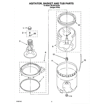

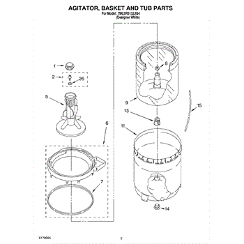

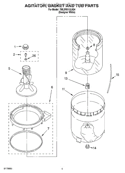

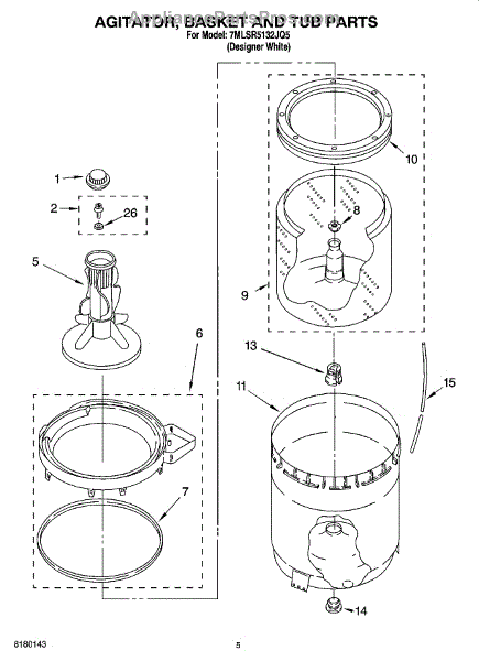

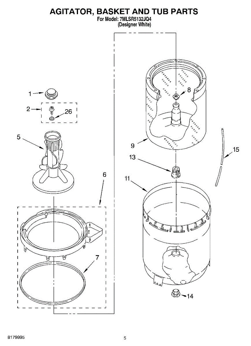

Parts for Whirlpool 7MLSR5132JQ5: 03 - Agitator, Basket And Tub Parts
