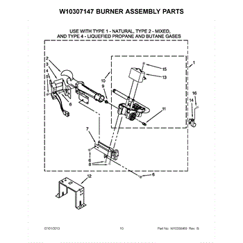

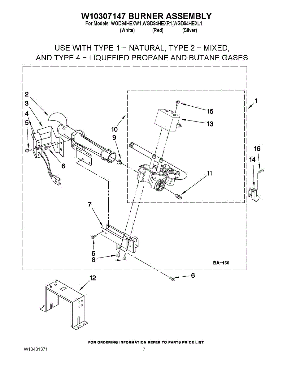

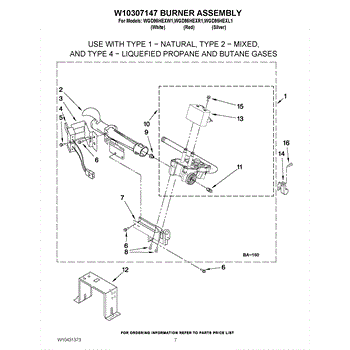

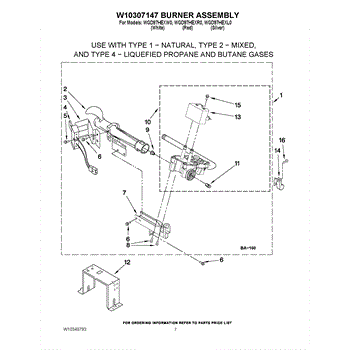

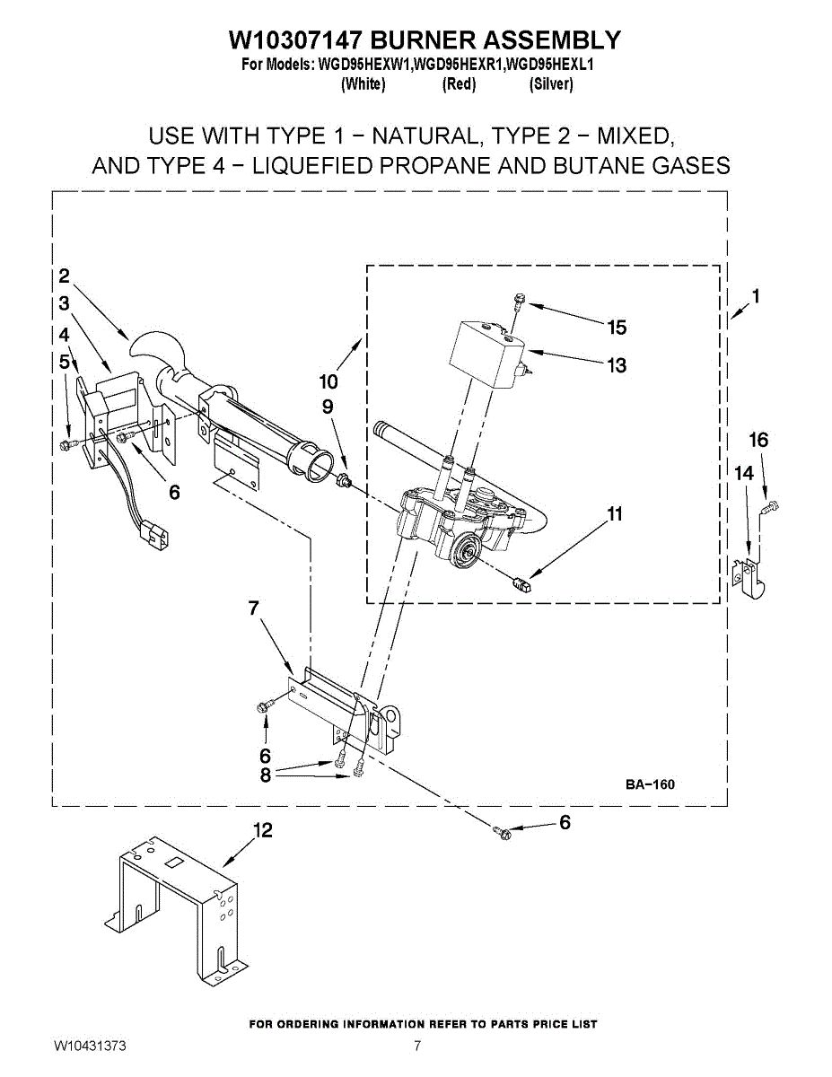

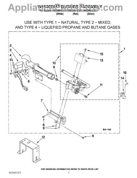

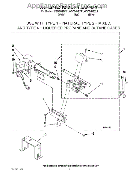

Parts for Whirlpool WGD94HEXW0: 05 - W10307147 Burner Assembly Parts
This genuine OEM replacement part is a burner and gas valve assembly for dryers. The burner and gas valve assembly is a complete assembly that contains the burner that distributes the gas in a way that creates an even flame allowing for heat to be distributed properly to perform the dryer's essential function. If the dryer is no longer drying clothes effectively or heating properly, then it might be time for it to be replaced. Luckily repairing a gas valve assembly is a relatively simple job.To replace the burner and gas valve assembly, begin by shutting off power to the appliance. Next, pull the dryer away from the wall to gain access to the back panel. Remove the back panel and locate the burner and gas valve assembly. Remove the mounting screws that hold it in place. After removing the screws use both hands to pull and release the old burner assembly. Set it off to the side and proceed to install the new one by refastening the screws that hold it in place.This replacement part is compatible with Whirlpool, Maytag, KitchenAid, Jenn-Air, Amana, Magic Chef, Admiral, Norge, Roper, and Sears/Kenmore brand washers.
