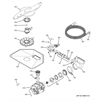

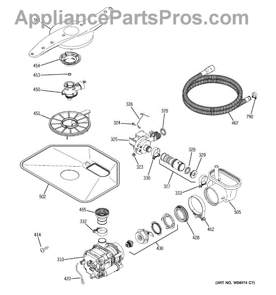

Parts for Ge GLD4260M15SS: 05 - Motor-Pump Mechanism Parts
