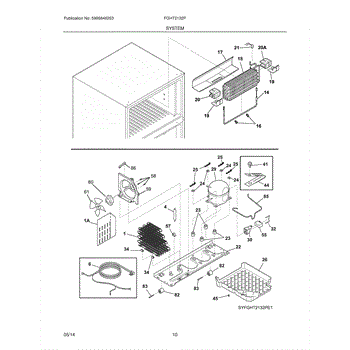

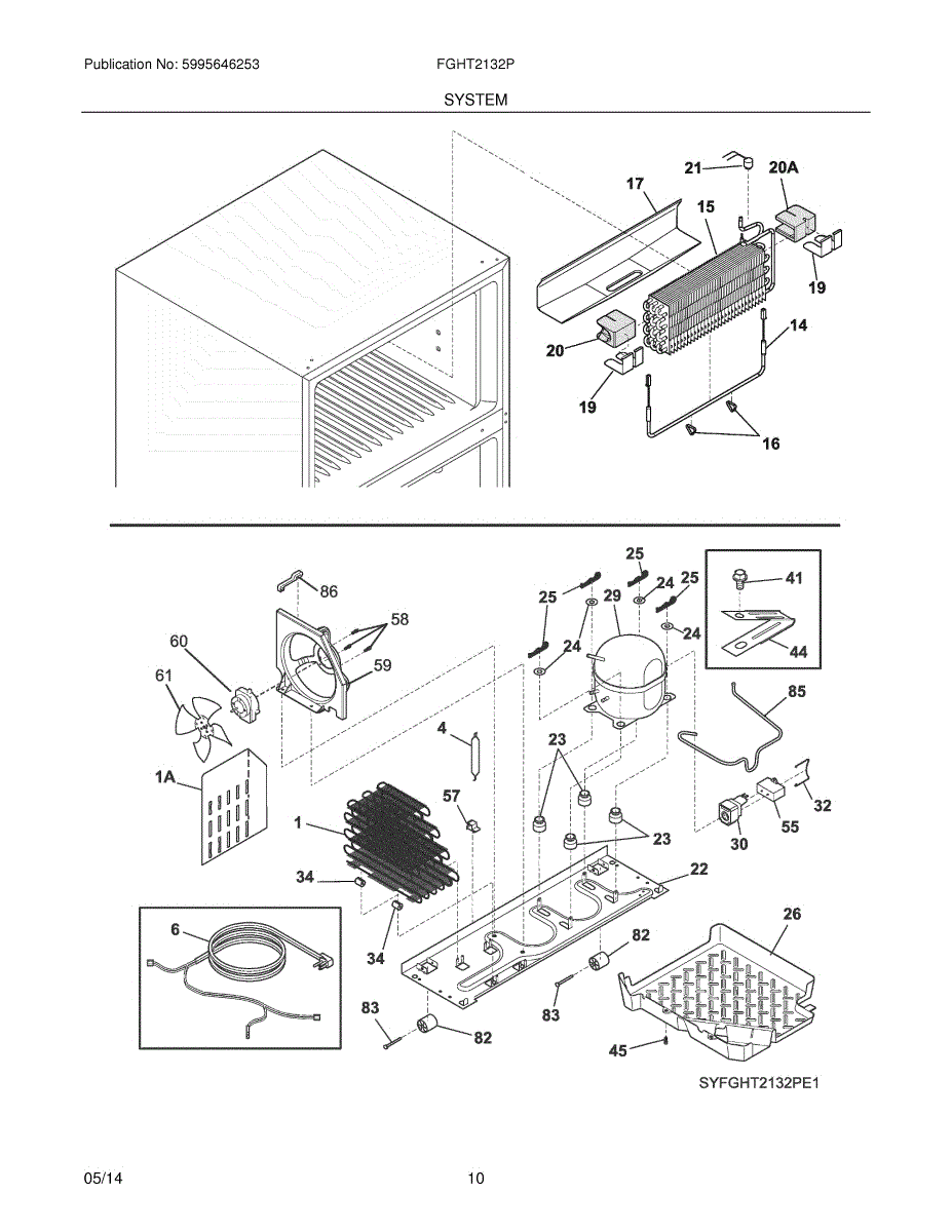

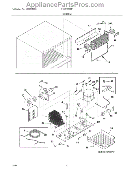

Parts for Frigidaire FGHT2132PP1: 09 - System Parts
