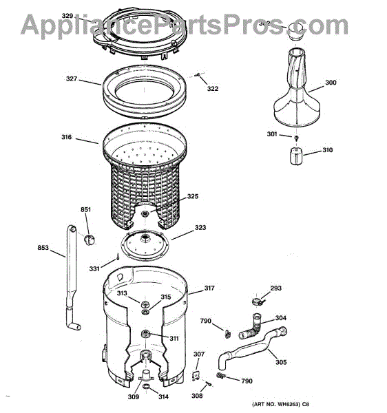

The Agitator Assembly is an OEM part for GE washing machines. This part moves clothes through the water and detergent during the wash cycle. This part ensures thorough cleaning by creating the necessary motion to distribute and cleanse laundry evenly.
Causes of a bad Agitator Assembly can range from wear and tear over extended use, to damage from overloading the washing machine, or even issues with the drive mechanism that powers the agitator's motion.
Symptoms of a bad Agitator Assembly include:
  • Clothes coming out of the wash still dirty or not as clean as expected
  • The washing machine making unusual noises during the wash cycle
  • The agitator not moving during the cycle or moving erratically
301
4.9 (16)
The GE screw is an OEM replacement part responsible for securing various components or parts together on a washing machine. Its main function is to connect and hold together various parts, panels, or brackets, ensuring that they remain securely in place during the appliance's operation. The screw comes in the size 1/4-20 MCH HXW 5/8 S, indicating its thread size, head type, and length.
  • Loose or wobbly components on the washing machine
  • Difficulty in assembling or disassembling parts due to missing or faulty screws
  • Certain parts becoming detached or separating during use
  • The washing machine vibrating excessively during use
  • Doors, panels, or knobs not staying securely in place
The GE washing machine screw can also be used on Hotpoint, RCA, and Kenmore/Sears appliances.
$4.90
$3.46
302
4.8 (9)
This is the short agitator cap for select top-load washers. It covers the top of the agitator to keep water and debris out of the agitator hub, preserving proper wash action and a clean appearance.
  • Seals the agitator opening to prevent moisture and detergent buildup inside the agitator
  • Helps maintain correct agitation by keeping the hub area protected
  • Common signs it's needed: missing or loose cap, cracked or warped cap, water or residue collecting inside the agitator
What's included: 1 short agitator cap Install notes:
  • Unplug the washer before servicing
  • Pull the old cap straight up to remove; some may require gentle prying
  • Press the new cap firmly into place until fully seated
  • Inspect the agitator hub for debris and clean before installing the new cap
$7.37
304
5.0 (31)
The Drain Pump Inlet Hose is an OEM part for GE washing machines. This hose plays a crucial role in the laundry process, ensuring that used water is efficiently removed from the washer, which helps in preventing standing water, odors, and potential mold growth inside the appliance.
Causes for issues with the drain pump inlet hose often involve natural wear and tear from constant exposure to water and laundry chemicals, physical damage from overloading or moving the washer, or blockages from lint, small garments, or other debris.
Symptoms of a malfunctioning Drain Pump Inlet Hose include:
  • Water leaking from the bottom or back of the washing machine
  • Slower than normal drain times, indicating possible clogs
  • Visible wear, cracks, or damage to the hose
$12.37
$14.71
$2.34
305
4.9 (9)
The Drain Hose is an OEM part for GE washing machines. It is specifically designed to channel used water out of the washer and into the household drainage system.
Causes of a bad drain hose can include physical damage from movement or installation, clogging from lint and debris, or degradation of the hose material over time, leading to leaks and inefficiency.
Symptoms of a bad Drain Hose include:
  • Water leaking from the back or underside of the washing machine
  • Pools of water around the area where the washing machine is installed
  • Signs of wear or damage to the hose, such as cracks, holes, or bulging
307
This tub clamp secures the washer tub or associated hoses to keep components aligned and sealed during operation. It replaces a worn or broken clamp to reduce movement and help prevent leaks and noise. What it does:
  • Holds the tub/hose connection or tub assembly parts together to maintain a tight fit
  • Helps prevent leaks caused by loose or damaged clamps
  • Reduces rubbing, vibration, and associated noise from a loose tub assembly
  • Restores proper component alignment after clamp failure
What's included: One tub clamp. Install notes:
  • Disconnect power and turn off water supply before starting any repair
  • Inspect mating parts (tub, hoses, mounting points) for damage and clean before installing
  • Use appropriate clamp pliers or screwdriver as required; ensure clamp is seated and tightened evenly
$6.72
$1.64
308
5/16-18 tpt ihw s n
$4.43
$3.93
309
4.7 (114)
The Tub Bearing is an OEM replacement part for GE washing machines. It is a critical component that supports the weight of the inner tub and allows for smooth rotation during the wash and spin cycles.
Causes of needing to replace the tub bearing include general wear and tear over time, exposure to excessive loads or unbalanced loads, or physical damage from impact or debris.
Symptoms of a bad tub bearing include:
  • Loud grinding or rumbling noises during the wash or spin cycle
  • Excessive vibration or shaking of the washing machine
  • Leaks due to increased stress on the tub and other components
$28.95
$34.74
$5.79
310
4.9 (100)
The Agitator Coupler is an OEM part for GE washing machines. It connects the agitator to the drive shaft, enabling the agitator to move and clean clothes effectively during the wash cycle.
You should replace the agitator coupler if it becomes damaged or worn out. Causes of a bad agitator coupler can include excessive load sizes, wear and tear from repeated use, or damage from foreign objects caught in the washer.
Symptoms of a bad agitator coupler include:
  • The agitator not moving or spinning properly
  • Unusual noises during the wash cycle
  • Poor cleaning performance
$14.64
$17.57
$2.93
311
4.8 (122)
This Tub Seal is an OEM replacement part for GE washing machines that is responsible for preventing water from leaking from the tub. This part is located at the base of the washing machine tub and creates a seal between the tub and the transmission to prevent water from leaking out during the wash cycle.
This part fixes the following symptoms-
  • Water leaking from the underside of the washing machine.
  • A musty or mildew smell coming from the machine.
  • Unusual noises during use.
Causes of a bad tub seal can range from normal wear and tear to a misaligned tub or an overloaded washing machine, which puts extra pressure on the seal. Additionally, the buildup of hard water minerals can degrade the seal's material over time.
$13.14
$2.19
313
4.8 (122)
This tub-bearing split ring is an OEM replacement part designed for GE washing machines. This part measures 2 inches in diameter. It is positioned between the inner and outer tubs to hold the tub bearing inside the outer tub. The Tub Bearing Split Ring not only supports the tub/hub assembly but also ensures smooth operation.
Symptoms of a bad Tub Bearing Split Ring include:
  • Excessive vibration or tub imbalance during spins
  • Loud clunking, knocking or grinding sounds
  • Reduced spin speeds or inability to achieve high RPMs
  • Premature tub or bearing wear requiring replacement
Causes can be extended use over time which leads to wear and fatigue of the split ring material. Cracks or breaks can develop, reducing its stability and load-bearing capacity.
This genuine GE replacement part is also compatible with Hotpoint, RCA and some Kenmore front-load models.
NOTE: For the washer outer tub seal order WH02X10383.
314
4.7 (100)
This tub-bearing washer is an OEM replacement part for GE washing machines. It is designed to keep your washing machine's inside tub spinning smoothly during cycles. The bearing Measures approximately 1 inch in inner diameter and 2 inches in outer diameter.
Causes of a bad tub-bearing washer can include wear and tear from extended use. Exposure to vibrations during high-speed spins may cause fatigue of the washer material over time as well.
Symptoms of a bad tub bearing washer include:
  • Excessive tub vibration or imbalance at high speeds
  • Abnormal noises such as grinding or clicking sounds
  • Premature failure of the tub bearing itself
  • Reduced spin capabilities or inability to hit maximum RPM
This OEM part is also compatible with Hotpoint, RCA and select Kenmore front-load washers.
$7.37
315
4.8 (61)
The Hub Washer is an OEM part for GE washing machines, designed to fit between the transmission and the inner tub. The hub washer acts as both a seal and a buffer, reducing wear on both the transmission and the tub by absorbing some of the operational stresses.
Causes of damage to the hub washer often include normal wear and tear from repeated use, exposure to harsh detergents or water conditions that can degrade the material, or overloading of the washing machine, which puts additional stress on mechanical components.
Symptoms of a bad Hub Washer include:
  • Leaks from the bottom of the washing machine
  • Unusual noises during the wash or spin cycles, such as grinding or squeaking
  • Difficulty in agitating or spinning, which could be caused by excessive friction or misalignment due to a worn or damaged hub washer.
$14.34
$2.39
316
317
This tub assembly replaces a cracked or leaking wash tub to restore proper water containment and drum support for your washer, helping reduce leaks, rubbing noises, and abnormal vibration during cycles. What it does:
  • Provides the sealed reservoir that holds wash water and supports the inner drum during wash and spin cycles
  • Helps stop or reduce water leaks caused by cracked or damaged tubs
  • Can resolve rubbing, scraping, or thumping noises from a warped or broken tub
  • Helps stabilize the drum to reduce vibration and improve spin performance
What's included: One tub assembly Install notes:
  • Disconnect power and shut off water supply before starting; wear gloves and eye protection
  • Tub assemblies are heavy and bulky—use two people or appropriate lifting equipment
  • Follow the washer OEM service manual for disassembly, seal transfer/replacement, and torque specifications
  • If bearings, seals, or mounting hardware show wear, replace them per OEM guidance for a complete repair
$183.59
$200.44
$16.85
322
A replacement baffle screw and flat washer used to secure the baffle or trim piece in ovens and ranges. Restores proper attachment to reduce vibration and keep the baffle aligned for normal operation. What it does
  • Secures the baffle or trim to the oven/range body and prevents movement or rattling.
  • Replaces missing, stripped, or corroded mounting hardware that can cause loose or misaligned baffles.
  • Helps maintain a tight fit so trim and baffle sit flush with surrounding panels.
  • Small, direct-replacement fastener for original baffle mounting points.
What's included One baffle screw and one flat washer. Install notes
  • Disconnect power and allow the appliance to cool before accessing internal panels.
  • Use the matching size screwdriver; start threads by hand to avoid cross-threading.
  • Tighten until snug — avoid over-tightening, which can strip threads or deform the washer.
  • Repair or replace the mounting bracket before installing this hardware.
$7.67
$0.69
323
4.8 (52)
The Inner Tub Mounting is an OEM part for GE washing machines. It secures the inner tub to the washer's outer tub, providing stability and support during the wash and spin cycles. This mounting component is crucial for the proper alignment and operation of the washer's drum.
Causes of a bad mounting include excessive loads, continuous use over time, or physical damage due to impacts or misalignment. A faulty inner tub mounting can lead to significant operational issues and potential damage to other components.
Symptoms of a bad inner tub mounting include:
  • Excessive vibration or shaking during wash or spin cycles
  • Unusual noises or banging sounds
  • The inner tub appearing misaligned or loose
  • Leaks from the washer during operation
$83.95
$100.74
$16.79
325
4.8 (135)
The Hub Nut is an OEM part for GE washing machines. This component secures the inner tub to the drive mechanism, ensuring that it remains in place during the agitation and spinning cycles. This lock-down nut is reverse threaded, meaning that it is loosed by rotating it clockwise. For easier removal of the old nut, it is recommended to use the tub nut spanner wrench WX5X1325.
Symptoms of a bad Hub Nut include:
  • Unusual noises like banging or grinding during the spin cycle.
  • The inner tub moving excessively or becoming loose.
  • Leakage around the center of the machine, indicating a seal failure possibly related to a loose hub nut.
  • Inefficiency in spinning or agitating clothes properly.
Causes of a bad hub nut can include corrosion due to exposure to water and detergent, improper initial installation, or loosening over time from the vibration and movement of the washing machine.
$22.39
$9.44
327
329
4.7 (10)
Outer tub cover kit that replaces a cracked or missing washer tub cover, protecting the inner tub and helping stop rubbing, noise and fabric snags. Restores proper tub clearance for smoother drum movement and quieter operation. What it does:
  • Covers the outer wash tub to protect the inner tub and fasteners from contact and wear
  • Helps stop rubbing, scraping or thumping sounds caused by tub-to-tub contact
  • Reduces the chance of clothes catching between the inner and outer tubs
  • Restores correct tub spacing so the drum spins without interference
What's included: One tub cover kit Install notes:
  • Access may require removing the agitator or inner tub and using basic hand tools
  • Inspect mounting clips, seals and surrounding components and replace any damaged items
  • Test the washer on a short cycle after installation to ensure proper fit and quiet operation
$122.42
$145.68
$23.26
331
Size: 14-10 a trt 7/8 s.
$7.37
790
This hose clamp kit secures the washer's hoses at the pump, tub, or valve connections, helping stop leaks and hose blow-offs. Replace worn or missing clamps to restore a tight, reliable seal during fill, wash, and drain.
  • Secures drain, pump, and fill hoses to fittings to maintain a watertight seal
  • Helps prevent drips, leaks, and hoses slipping off during vibration
  • Replaces clamps that are rusted, stripped, deformed, or missing
  • Common symptoms: water leaking at hose joints, loose hose connections, clamp won't tighten
  • Useful when installing a new hose, pump, or valve
What's included: Hose clamp kit as supplied by the manufacturer. Install notes:
  • Unplug the washer and turn off water supplies; have towels or a pan ready for residual water
  • Release and remove old clamps; seat the hose fully over the fitting before installing new clamps

This flood hose gasket seals the joint where the washer's flood/overflow hose connects to the outer tub. A fresh seal helps stop seepage from the tub area, preventing drips or moisture around the top or rear of the washer.
  • Creates a watertight seal at the flood/overflow hose connection to the outer tub
  • Helps prevent leaks during fill, wash, and spin
  • Typical failure signs: drips from the top/back of the tub, visible cracks or deformation, or a loose hose connection
What's included: 1 flood hose gasket Install notes:
  • Disconnect power and turn off water supply before servicing
  • Access the flood hose connection at the tub; remove the hose and old gasket
  • Seat the new gasket fully and reconnect the hose securely
  • Run a short cycle to check for leaks
