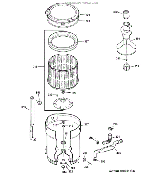

The Agitator Assembly is an OEM part for GE washing machines. This essential component is responsible for moving clothes during the wash cycle, ensuring thorough cleaning by continually shifting the laundry within the drum. The agitator's design includes fins or vanes that help to circulate water and detergent through the clothes, effectively removing dirt without causing excessive wear to the fabric.
Symptoms of a bad Agitator Assembly include:
  • The agitator not moving or only moving weakly during the wash cycle.
  • Unusual noises like grinding or thumping indicating mechanical issues.
  • Clothes coming out still dirty or less clean than expected, suggesting insufficient agitation.
  • The top portion of the agitator moving independently from the base, known as "stripped" agitator dogs.
Causes of a bad agitator can include worn out mechanical parts such as gears or bearings, a damaged drive shaft, or the agitator becoming detached from the transmission due to loosening of the securing bolt.
This GE replacement part is also compatible with Hotpoint, RCA, and some Kenmore models,
Pro Tip: When replacing the agitator, also consider replacing the agitator coupling (WH49X10042).

The GE screw is an OEM replacement part responsible for securing various components or parts together on a washing machine. Its main function is to connect and hold together various parts, panels, or brackets, ensuring that they remain securely in place during the appliance's operation. The screw comes in the size 1/4-20 MCH HXW 5/8 S, indicating its thread size, head type, and length.
  • Loose or wobbly components on the washing machine
  • Difficulty in assembling or disassembling parts due to missing or faulty screws
  • Certain parts becoming detached or separating during use
  • The washing machine vibrating excessively during use
  • Doors, panels, or knobs not staying securely in place
The GE washing machine screw can also be used on Hotpoint, RCA, and Kenmore/Sears appliances.

The Fabric Softener Dispenser is an OEM replacement part for GE washers. It is located on the top of the agitator. This dispenser allows for easy addition of fabric softener or other washing aids at the ideal time in the cycle. With a simple twist and pour into the reservoir, it then evenly releases the solution to condition clothes during the final rinse.
Causes of a bad dispenser can include cracks or leaks allowing premature discharge into the wash drum. Mineral buildup may also clog the release nozzles.
Symptoms of a bad dispenser include:
  • Fabric softener not fully dispensing or splashing outside the dispenser cup
  • Stains or residue transferring onto clothes from residues
  • Strong chemical smells if the contents extra release early
This GE OEM replacement part is also compatible with Hotpoint, RCA, and some Kenmore models.

The Drain Pump Inlet Hose is an OEM part for GE washing machines. This hose plays a crucial role in the laundry process, ensuring that used water is efficiently removed from the washer, which helps in preventing standing water, odors, and potential mold growth inside the appliance.
Causes for issues with the drain pump inlet hose often involve natural wear and tear from constant exposure to water and laundry chemicals, physical damage from overloading or moving the washer, or blockages from lint, small garments, or other debris.
Symptoms of a malfunctioning Drain Pump Inlet Hose include:
  • Water leaking from the bottom or back of the washing machine
  • Slower than normal drain times, indicating possible clogs
  • Visible wear, cracks, or damage to the hose

This tub clamp secures the washer tub or associated hoses to keep components aligned and sealed during operation. It replaces a worn or broken clamp to reduce movement and help prevent leaks and noise. What it does:
  • Holds the tub/hose connection or tub assembly parts together to maintain a tight fit
  • Helps prevent leaks caused by loose or damaged clamps
  • Reduces rubbing, vibration, and associated noise from a loose tub assembly
  • Restores proper component alignment after clamp failure
What's included: One tub clamp. Install notes:
  • Disconnect power and turn off water supply before starting any repair
  • Inspect mating parts (tub, hoses, mounting points) for damage and clean before installing
  • Use appropriate clamp pliers or screwdriver as required; ensure clamp is seated and tightened evenly

5/16-18 tpt ihw s n

The Tub Bearing is an OEM replacement part for GE washing machines. It is a critical component that supports the weight of the inner tub and allows for smooth rotation during the wash and spin cycles.
Causes of needing to replace the tub bearing include general wear and tear over time, exposure to excessive loads or unbalanced loads, or physical damage from impact or debris.
Symptoms of a bad tub bearing include:
  • Loud grinding or rumbling noises during the wash or spin cycle
  • Excessive vibration or shaking of the washing machine
  • Leaks due to increased stress on the tub and other components

The Agitator Coupler is an OEM part for GE washing machines. It connects the agitator to the drive shaft, enabling the agitator to move and clean clothes effectively during the wash cycle.
You should replace the agitator coupler if it becomes damaged or worn out. Causes of a bad agitator coupler can include excessive load sizes, wear and tear from repeated use, or damage from foreign objects caught in the washer.
Symptoms of a bad agitator coupler include:
  • The agitator not moving or spinning properly
  • Unusual noises during the wash cycle
  • Poor cleaning performance

This Tub Seal is an OEM replacement part for GE washing machines that is responsible for preventing water from leaking from the tub. This part is located at the base of the washing machine tub and creates a seal between the tub and the transmission to prevent water from leaking out during the wash cycle.
This part fixes the following symptoms-
  • Water leaking from the underside of the washing machine.
  • A musty or mildew smell coming from the machine.
  • Unusual noises during use.
Causes of a bad tub seal can range from normal wear and tear to a misaligned tub or an overloaded washing machine, which puts extra pressure on the seal. Additionally, the buildup of hard water minerals can degrade the seal's material over time.

This tub-bearing split ring is an OEM replacement part designed for GE washing machines. This part measures 2 inches in diameter. It is positioned between the inner and outer tubs to hold the tub bearing inside the outer tub. The Tub Bearing Split Ring not only supports the tub/hub assembly but also ensures smooth operation.
Symptoms of a bad Tub Bearing Split Ring include:
  • Excessive vibration or tub imbalance during spins
  • Loud clunking, knocking or grinding sounds
  • Reduced spin speeds or inability to achieve high RPMs
  • Premature tub or bearing wear requiring replacement
Causes can be extended use over time which leads to wear and fatigue of the split ring material. Cracks or breaks can develop, reducing its stability and load-bearing capacity.
This genuine GE replacement part is also compatible with Hotpoint, RCA and some Kenmore front-load models.
NOTE: For the washer outer tub seal order WH02X10383.

This tub-bearing washer is an OEM replacement part for GE washing machines. It is designed to keep your washing machine's inside tub spinning smoothly during cycles. The bearing Measures approximately 1 inch in inner diameter and 2 inches in outer diameter.
Causes of a bad tub-bearing washer can include wear and tear from extended use. Exposure to vibrations during high-speed spins may cause fatigue of the washer material over time as well.
Symptoms of a bad tub bearing washer include:
  • Excessive tub vibration or imbalance at high speeds
  • Abnormal noises such as grinding or clicking sounds
  • Premature failure of the tub bearing itself
  • Reduced spin capabilities or inability to hit maximum RPM
This OEM part is also compatible with Hotpoint, RCA and select Kenmore front-load washers.

The Hub Washer is an OEM part for GE washing machines, designed to fit between the transmission and the inner tub. The hub washer acts as both a seal and a buffer, reducing wear on both the transmission and the tub by absorbing some of the operational stresses.
Causes of damage to the hub washer often include normal wear and tear from repeated use, exposure to harsh detergents or water conditions that can degrade the material, or overloading of the washing machine, which puts additional stress on mechanical components.
Symptoms of a bad Hub Washer include:
  • Leaks from the bottom of the washing machine
  • Unusual noises during the wash or spin cycles, such as grinding or squeaking
  • Difficulty in agitating or spinning, which could be caused by excessive friction or misalignment due to a worn or damaged hub washer.

This tub assembly replaces a cracked or leaking wash tub to restore proper water containment and drum support for your washer, helping reduce leaks, rubbing noises, and abnormal vibration during cycles. What it does:
  • Provides the sealed reservoir that holds wash water and supports the inner drum during wash and spin cycles
  • Helps stop or reduce water leaks caused by cracked or damaged tubs
  • Can resolve rubbing, scraping, or thumping noises from a warped or broken tub
  • Helps stabilize the drum to reduce vibration and improve spin performance
What's included: One tub assembly Install notes:
  • Disconnect power and shut off water supply before starting; wear gloves and eye protection
  • Tub assemblies are heavy and bulky—use two people or appropriate lifting equipment
  • Follow the washer OEM service manual for disassembly, seal transfer/replacement, and torque specifications
  • If bearings, seals, or mounting hardware show wear, replace them per OEM guidance for a complete repair

A replacement baffle screw and flat washer used to secure the baffle or trim piece in ovens and ranges. Restores proper attachment to reduce vibration and keep the baffle aligned for normal operation. What it does
  • Secures the baffle or trim to the oven/range body and prevents movement or rattling.
  • Replaces missing, stripped, or corroded mounting hardware that can cause loose or misaligned baffles.
  • Helps maintain a tight fit so trim and baffle sit flush with surrounding panels.
  • Small, direct-replacement fastener for original baffle mounting points.
What's included One baffle screw and one flat washer. Install notes
  • Disconnect power and allow the appliance to cool before accessing internal panels.
  • Use the matching size screwdriver; start threads by hand to avoid cross-threading.
  • Tighten until snug — avoid over-tightening, which can strip threads or deform the washer.
  • Repair or replace the mounting bracket before installing this hardware.

The Hub Nut is an OEM part for GE washing machines. This component secures the inner tub to the drive mechanism, ensuring that it remains in place during the agitation and spinning cycles. This lock-down nut is reverse threaded, meaning that it is loosed by rotating it clockwise. For easier removal of the old nut, it is recommended to use the tub nut spanner wrench WX5X1325.
Symptoms of a bad Hub Nut include:
  • Unusual noises like banging or grinding during the spin cycle.
  • The inner tub moving excessively or becoming loose.
  • Leakage around the center of the machine, indicating a seal failure possibly related to a loose hub nut.
  • Inefficiency in spinning or agitating clothes properly.
Causes of a bad hub nut can include corrosion due to exposure to water and detergent, improper initial installation, or loosening over time from the vibration and movement of the washing machine.

This balance ring assembly helps stabilize the washer tub during spin cycles to reduce vibration and noisy operation. Replaces a worn or damaged counterweight to restore smoother, more balanced spinning. What it does:
  • Acts as a counterweight around the washer tub to help reduce vibration and wobbling during high-speed spins
  • Helps decrease noise caused by an unbalanced load or damaged tub support
  • Can prevent excessive movement that may cause wear to suspension components
  • Commonly replaced when you see persistent shaking, loud knocking during spin, or visible damage to the ring
  • One balance ring assembly
  • Designed for use with compatible top-load washer tubs; confirm fit for your model before ordering
  • Basic mechanical skill and common hand tools required; larger repairs may require tub removal
  • Disconnect power and water supply before starting any repair to avoid injury or damage

The tub cover assembly seals the top of the washer's outer tub to contain splashes and keep the basket clear. Replacing a damaged cover helps stop leaks from the top area and restores clean, consistent wash performance.
  • Seals the outer tub opening to prevent water from escaping during fill and agitation
  • Helps direct water back into the tub and reduces splashing
  • Maintains proper basket clearance to avoid rubbing or scraping
  • Common signs it's failing: water leaking or splashing from the top/sides, visible cracks or broken tabs, loose or misaligned cover, rubbing noises
What's included: 1 tub cover assembly Install notes:
  • Disconnect power and water supplies before servicing; wear gloves to protect hands
  • Lift/remove the top or lid as needed to access the tub opening
  • Release the retaining fasteners/clamps and carefully lift off the old cover; note orientation
  • Seat the new cover evenly, align all tabs, reinstall fasteners, and test for leaks and basket clearance

This machine screw secures panels, brackets, and internal components in compatible washers. Replacing a missing or stripped fastener restores a tight fit to help reduce vibration and keep parts properly aligned.
  • 10-32 thread; 5/8-inch length; Torx T25 drive
  • Fastens components and panels to resist loosening from vibration
  • Replaces lost, corroded, or stripped screws
  • Helps address loose or rattling panels, misalignment, or hardware that won't tighten
  • Unplug the appliance and turn off water supply before servicing
  • Use a T25 Torx driver; start threads by hand to avoid cross-threading
  • Tighten snugly; do not overtighten
  • Repair or replace the bracket/panel for a secure hold

This hose clamp kit secures the washer's hoses at the pump, tub, or valve connections, helping stop leaks and hose blow-offs. Replace worn or missing clamps to restore a tight, reliable seal during fill, wash, and drain.
