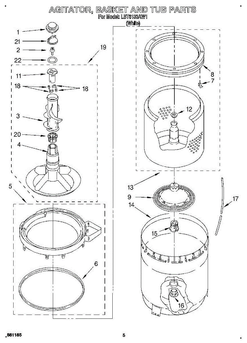

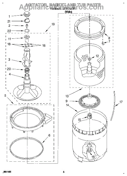

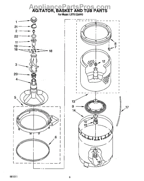

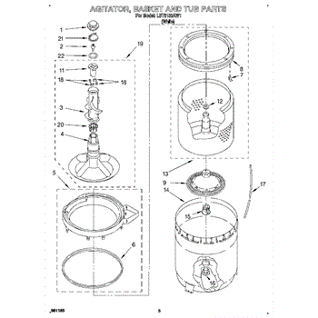

Parts for Whirlpool LBT6133AW1: 03 - Agitator, Basket And Tub Parts
