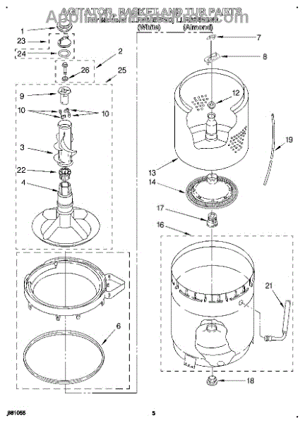

Parts for Whirlpool LLR5144BW0: 03 - Agitator, Basket And Tub Parts
