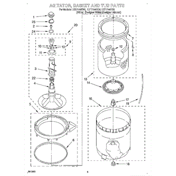

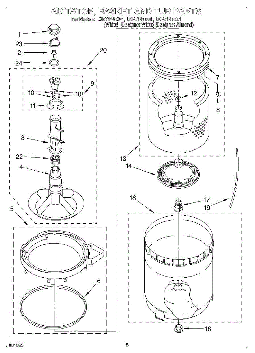

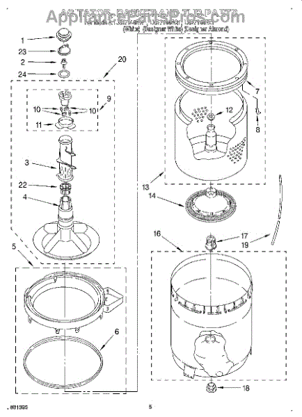

Parts for Whirlpool LXR7144EW0: 03 - Agitator, Basket And Tub Parts
