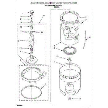

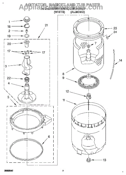

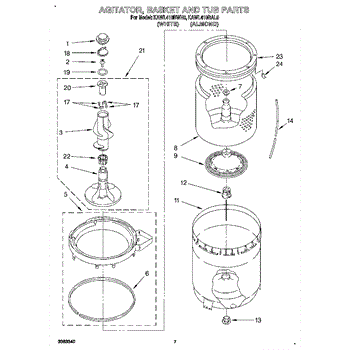

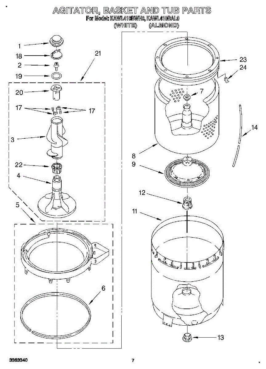

Parts for Kitchenaid KAWL410BWH0: 05 - Agitator, Basket And Tub Parts
