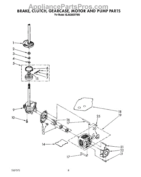

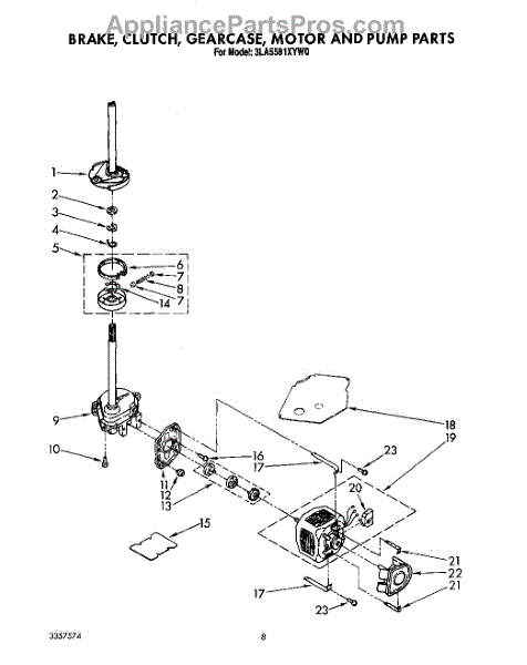

Parts for Whirlpool 6LA6300XYN0: 06 - Brake, Clutch, Gearcase, Motor And Pump Parts
