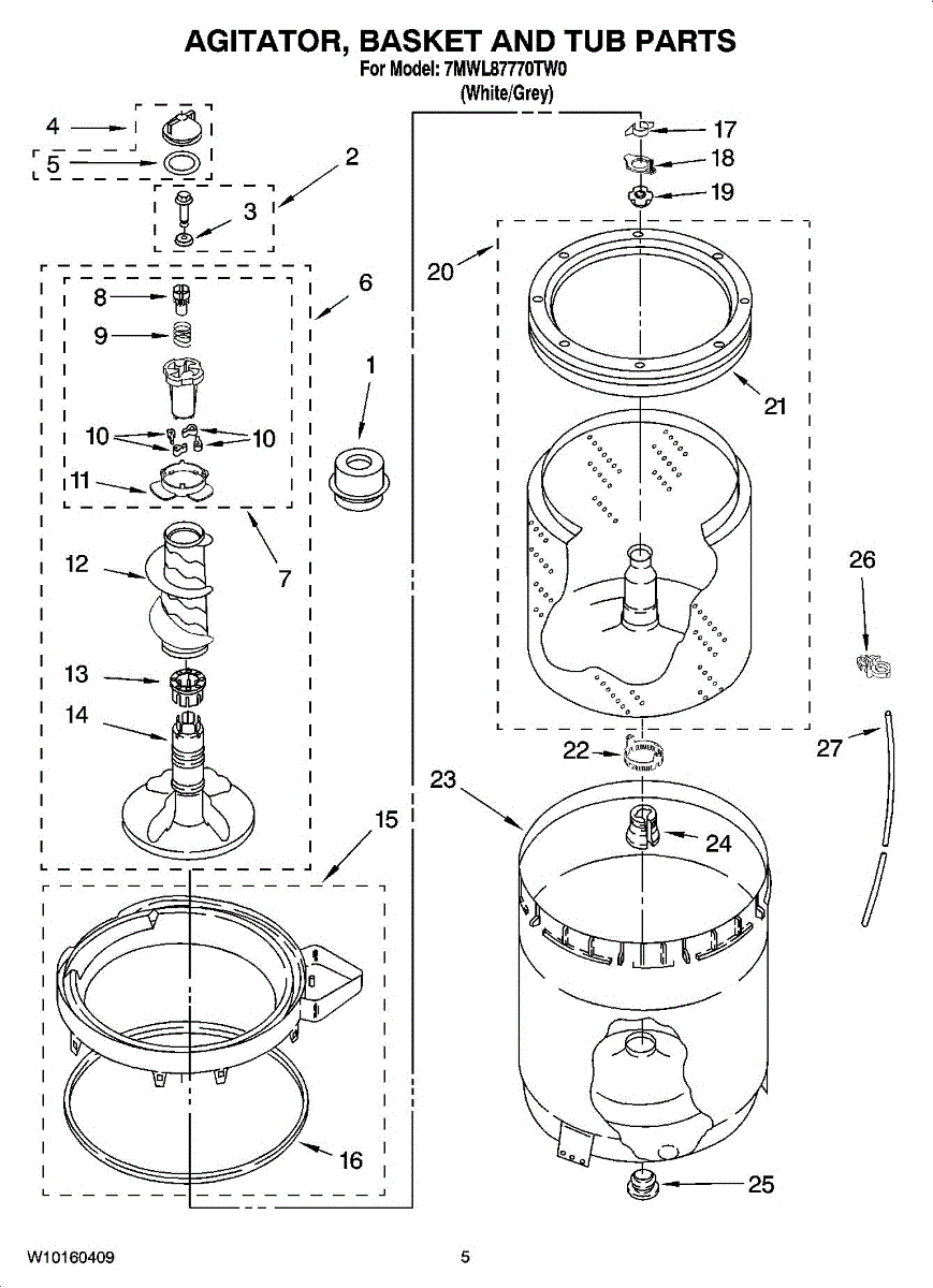

Parts for Whirlpool 7MWL87770TW0: 03 - Agitator, Basket And Tub Parts

Over time, the agitator washer can wear out or become damaged due to the constant movement and pressure exerted during wash cycles. Causes of a bad agitator washer can include normal wear and tear, exposure to heavy loads, or misuse that puts excessive stress on the part.
Symptoms of a bad agitator washer include:
  • Agitator not moving or moving improperly
  • Unusual noises during the agitation cycle
  • Poor cleaning performance
  • Agitator becoming loose or detached
$13.56
$16.14
$2.58
4.9 (28)
The Spanner Nut is an OEM part for Whirlpool washing machines. This nut secures the washer tub to the drive shaft, ensuring that the tub remains stable during the wash and spin cycles. Properly securing the tub is crucial for the machine's performance and longevity, as it helps maintain balance and reduce vibrations.
You should replace the spanner nut if it becomes loose or stripped. Causes of a bad spanner nut can include over-tightening, regular wear and tear, or damage from heavy loads. Exposure to moisture and detergent over time can also lead to corrosion, compromising the nut's ability to secure the tub effectively.
Symptoms of a bad spanner nut include:
  • Excessive vibrations or shaking during the wash cycle
  • Loud banging or knocking noises
  • The washer tub being loose or misaligned
  • Leaks around the tub area
Tool for removing the spanner nut - TB123B.
$1.89
4.9 (11)
This is an inner tub basket intended for use with washing machines and combination washers and dryers. It is located inside the washing machine in the middle of the appliance. The inner tub basket is responsible for holding clothing during a washing cycle. It has an agitator in the middle and sides with holes so that water can leave when the tub is spinning. It is attached to the outer tub, which seals in the water.The inner tub basket can become damaged and cause loud noises, leak, or fail to drain. If this occurs, this component will need to be replaced. Basic tools will be needed for the process. Make sure the washing machine is unplugged for safety. The hoses will need to be removed before taking out the inner tub basket and replacing it with a new one. The inner tub basket is sold on an individual basis. It is an authentic OEM replacement part that is sourced directly from the manufacture. This part is compatible with washing machines and washer/dryer combination appliances made by Inglis, Estate, Admiral, Crosley, Roper, Magic Chef, Amana, KitchenAid, Maytag, Kenmore, and Whirlpool.
$298.49
$338.10
$39.61
4.9 (11)
The Balance Ring is an OEM part for Whirlpool washing machines. This part maintains the stability of the washer drum during the spin cycle. It contains liquid that helps balance the load, minimizing vibrations and noise while ensuring smooth operation.
Causes of a bad balance ring can include general wear and tear, exposure to heavy or unbalanced loads, or physical damage.
Symptoms of a bad balance ring include:
  • Excessive shaking or vibrating during the spin cycle
  • Loud banging noises
  • Washer moving or walking during operation
  • Uneven or off-balance loads
$79.56
$94.68
$15.12
4.8 (8)
This is an outer tub for washing machines. The outer tub and holds the inner tub and makes sure water doesn't leak into the rest of the appliance. A damaged outer tub will often make loud noises and could cause leaks.When replacing the outer tub, make sure the washing machine is unplugged and the water supply is turned off. Remove the control panel before disassembling the washing machine to get access to the outer tub. Tap the drive block and disconnect the outer tub before pulling the hose free and removing the suspension springs. The new part can be installed in the new place before turning the power and water back on. This outer tub is made for use with washing machines and washer and dryer combination appliances made by Whirlpool, Kenmore, Maytag, KitchenAid, Amana, Magic Chef, Admiral, Roper, Crosley, Inglis, and Estate. This is a genuine OEM replacement part that is directly sourced from the manufacturer. It is sold as a single part.
$231.95
$258.92
$26.97
4.8 (89)
The Washer Drive Block is an OEM part for Whirlpool washing machines. This component is situated between the washer's transmission and the inner tub, playing a key role in transferring the rotational motion from the motor to the tub.
Causes for replacement often stem from normal wear and tear, which can lead to the drive block becoming worn or damaged. This wear can prevent the drive block from properly engaging with the tub, leading to inefficient cycles and potential damage to other parts of the washing machine.
Symptoms of a bad Washer Drive Block include:
  • The washer tub has difficulty agitating or spinning.
  • A loud noise during the spin cycle, indicating that the tub is not engaging correctly with the transmission.
  • The machine vibrates excessively or seems off-balance, even with a balanced load.
$18.95
$22.74
$3.79
4.8 (78)
The Centerpost Gasket is an OEM replacement part for Whirlpool washers. This component serves as a vital seal around the center post or agitator shaft, preventing water leaks and ensuring proper operation during wash cycles.
Symptoms of a failing centerpost gasket may include:
  • Water leaking from the top or bottom of the washer tub
  • Excessive moisture buildup around the agitator area
  •  Potential mold or mildew growth due to leaks
Causes of needing to replace the centerpost gasket can include normal wear and tear over extended use, damage or deterioration from exposure to heat or chemicals, or physical tearing or displacement of the gasket material.
This OEM part is also compatible with Maytag, KitchenAid, Jenn-Air, Amana, Magic Chef, Admiral, Norge, Roper, and Kenmore washer models.
$9.54
$1.59
A small retainer clip that secures panels, hoses or wiring to keep components in place and reduce noise from loose parts. Replacing a worn or broken clip restores proper fit and helps prevent intermittent contact or rattling. What it does
  • Secures trim, panels, hoses or wire harnesses to mounting points to prevent movement.
  • Keeps components aligned so switches and seals engage correctly.
  • Stops rattling or vibrating noises caused by loose parts.
  • Helps prevent abrasion or chafing of wires and hoses by holding them away from edges.
What's included One retainer clip. Install notes
  • Install by snapping or sliding the clip into the factory mounting slot; use needle-nose pliers if needed.
  • Power off and unplug the appliance before accessing internal parts.
  • Inspect surrounding mounts and mating tabs for damage; replace if worn for a secure fit.
  • If removal is difficult, apply a small amount of penetrating lubricant and work carefully to avoid breaking adjacent plastic.
$29.76
$31.16
$1.40
This is a clear plastic hose that runs from the water level switch to the bottom of the tub.
The Water Level Pressure Switch Hose is an OEM part for Whirlpool washers, playing a critical role in the accurate measurement of water levels within the machine.
Causes of damage to the Water Level Pressure Switch Hose can stem from natural wear and tear over time, leading to cracks or holes in the hose.
Symptoms of a bad Water Level Pressure Switch Hose include:
  • The washer overfills or underfills, indicating a problem with water level detection.
  • Unusual noises during the fill cycle, which may suggest air leaks in the hose.
  • Error codes related to water level or filling issues displayed on the washer.
  • The machine stops mid-cycle due to incorrect water level readings.
$47.95
$57.06
$9.11
