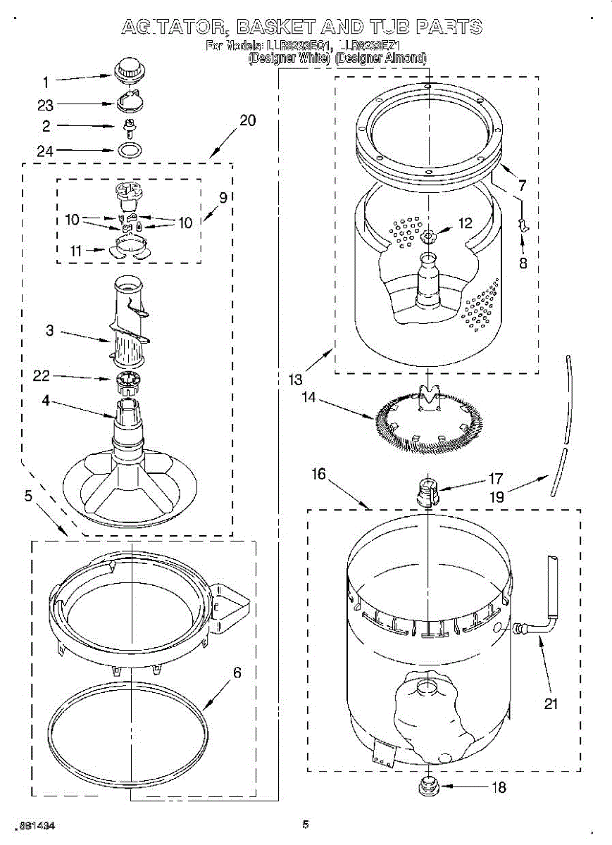

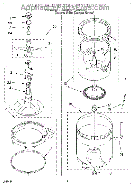

Parts for Whirlpool LLR8233EZ1: 03 - Agitator, Basket, And Tub Parts
