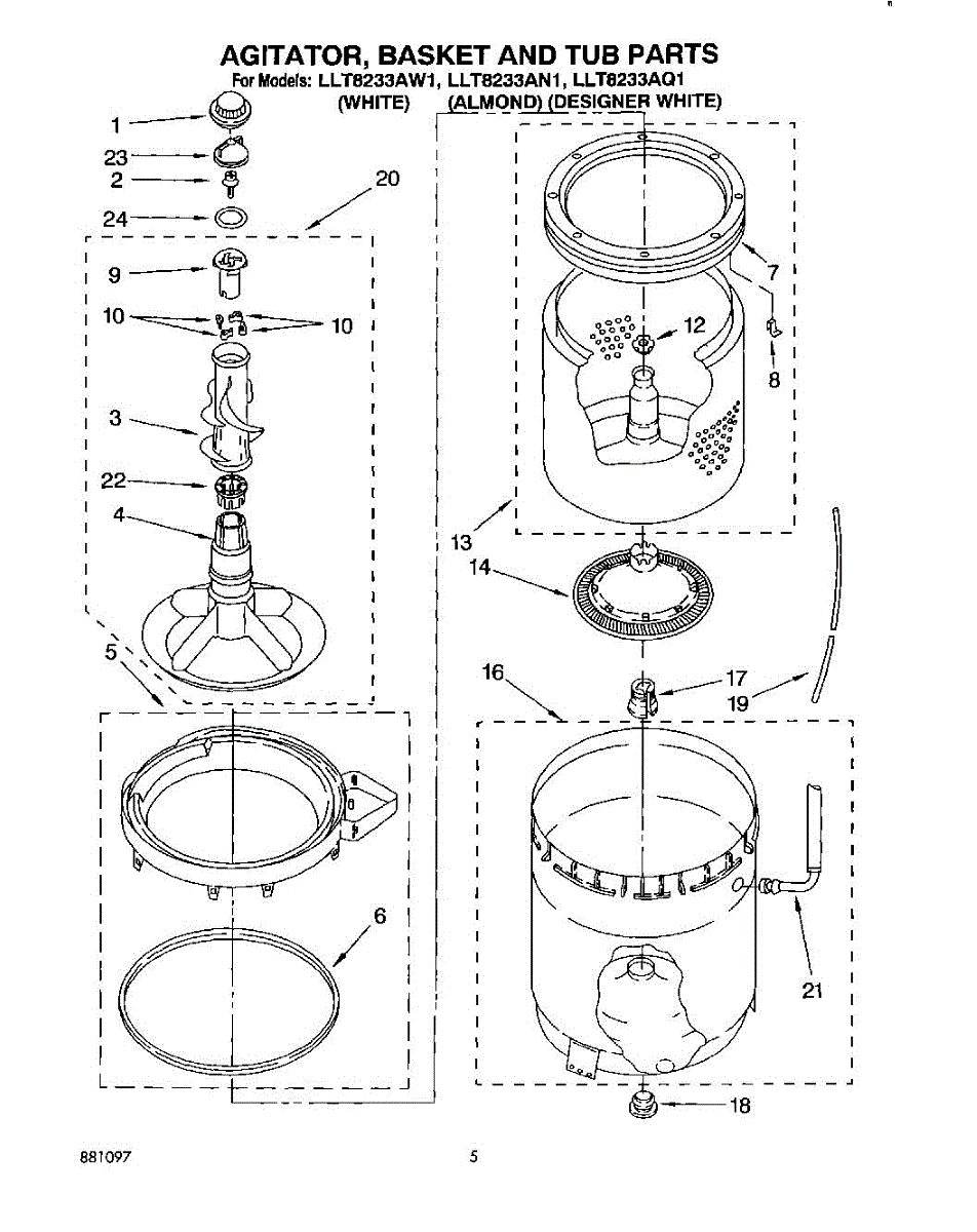

Parts for Whirlpool LLT8233AN1: 03 - Agitator, Basket And Tub Parts
