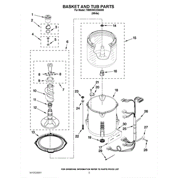

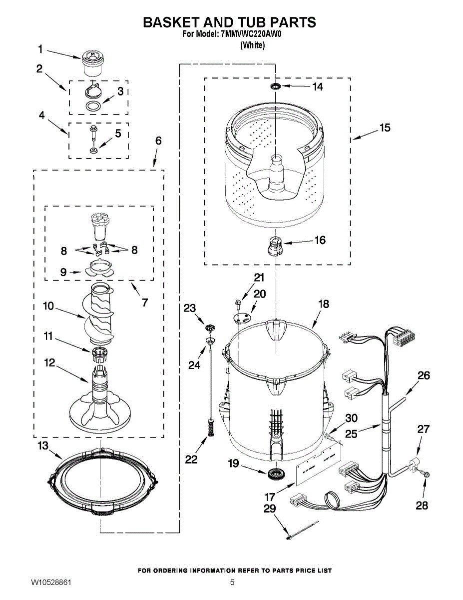

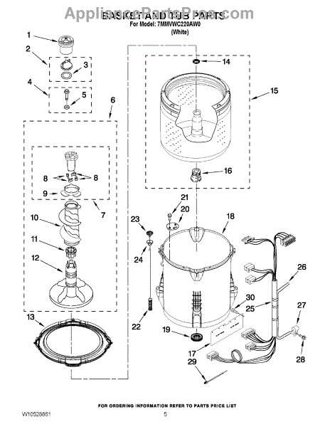

Parts for Maytag 7MMVWC220AW0: 03 - Basket And Tub Parts
