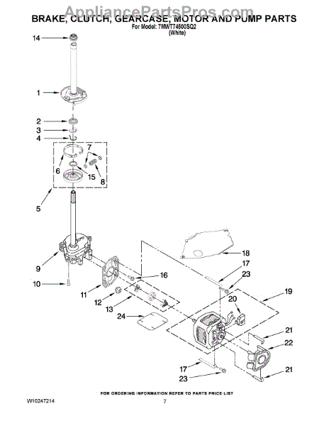

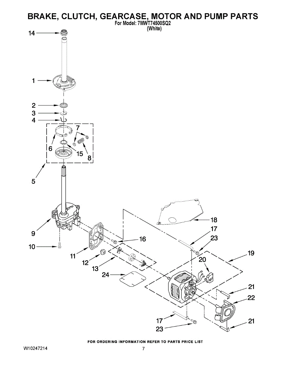

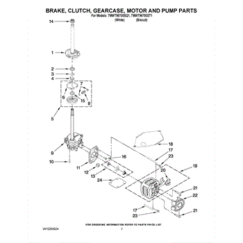

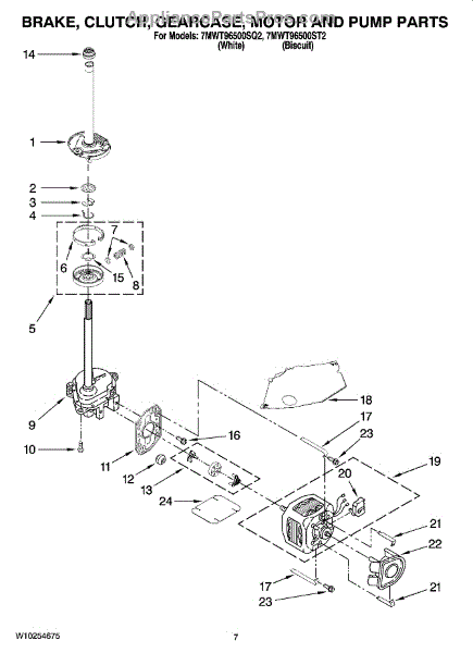

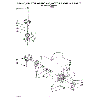

Parts for Whirlpool 7MWT74500SQ2: 04 - Brake, Clutch, Gearcase, Motor And Pump Parts
