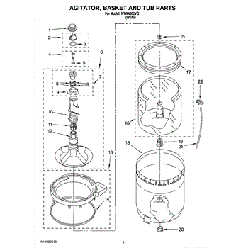

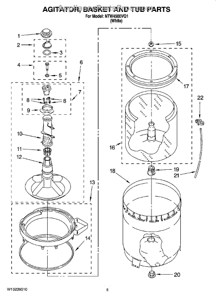

Parts for Maytag NTW4500VQ0: 03 - Agitator, Basket And Tub Parts
