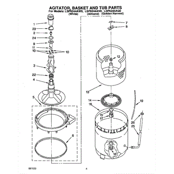

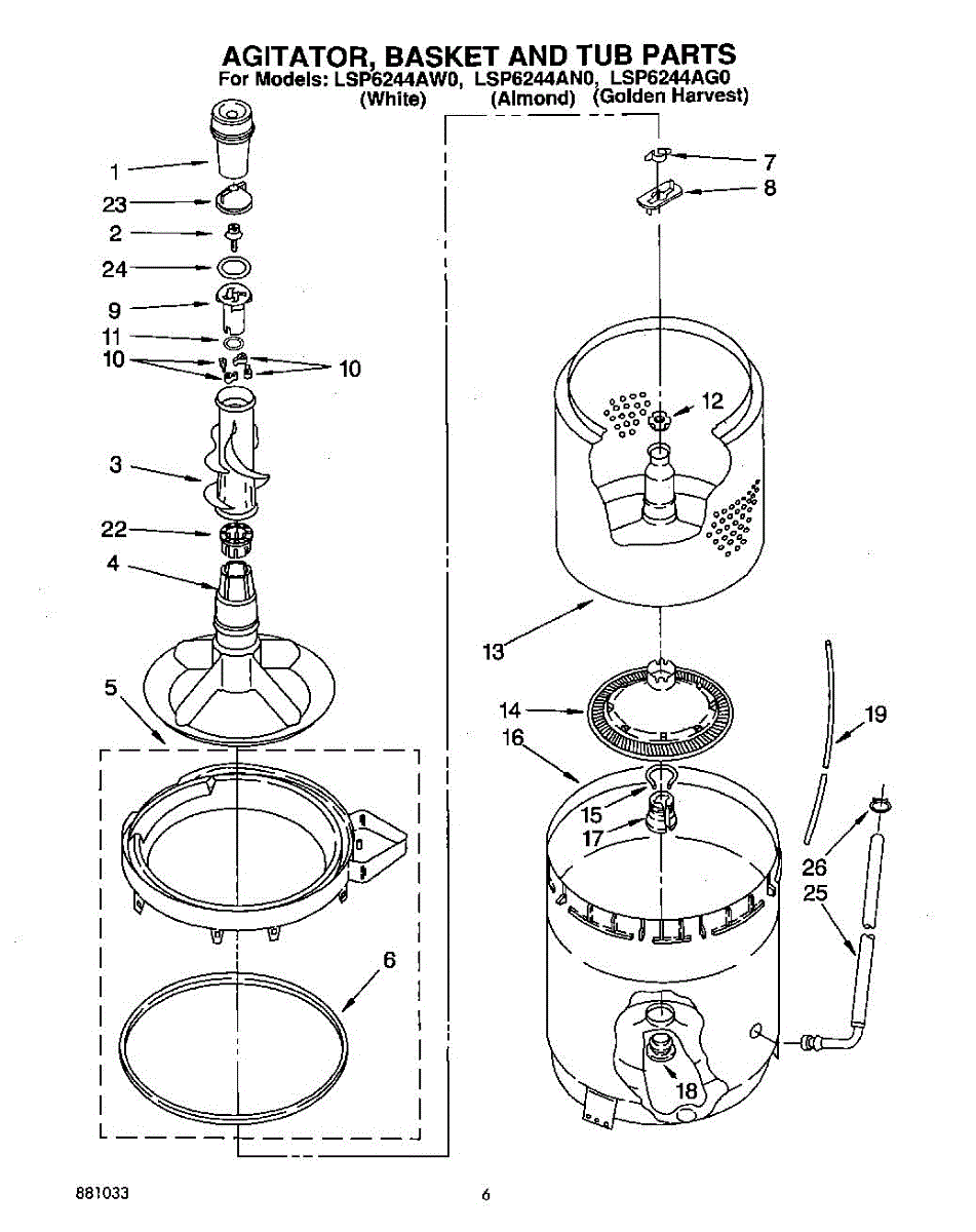

Parts for Whirlpool LSP6244AG0: 04 - Agitator, Basket And Tub Parts
