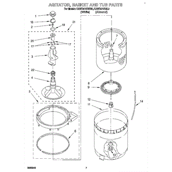

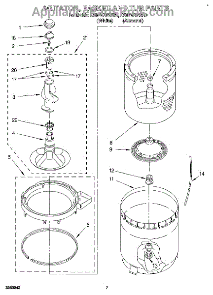

Parts for Kitchenaid KAWE470BAL0: 05 - Agitator, Basket And Tub Parts
