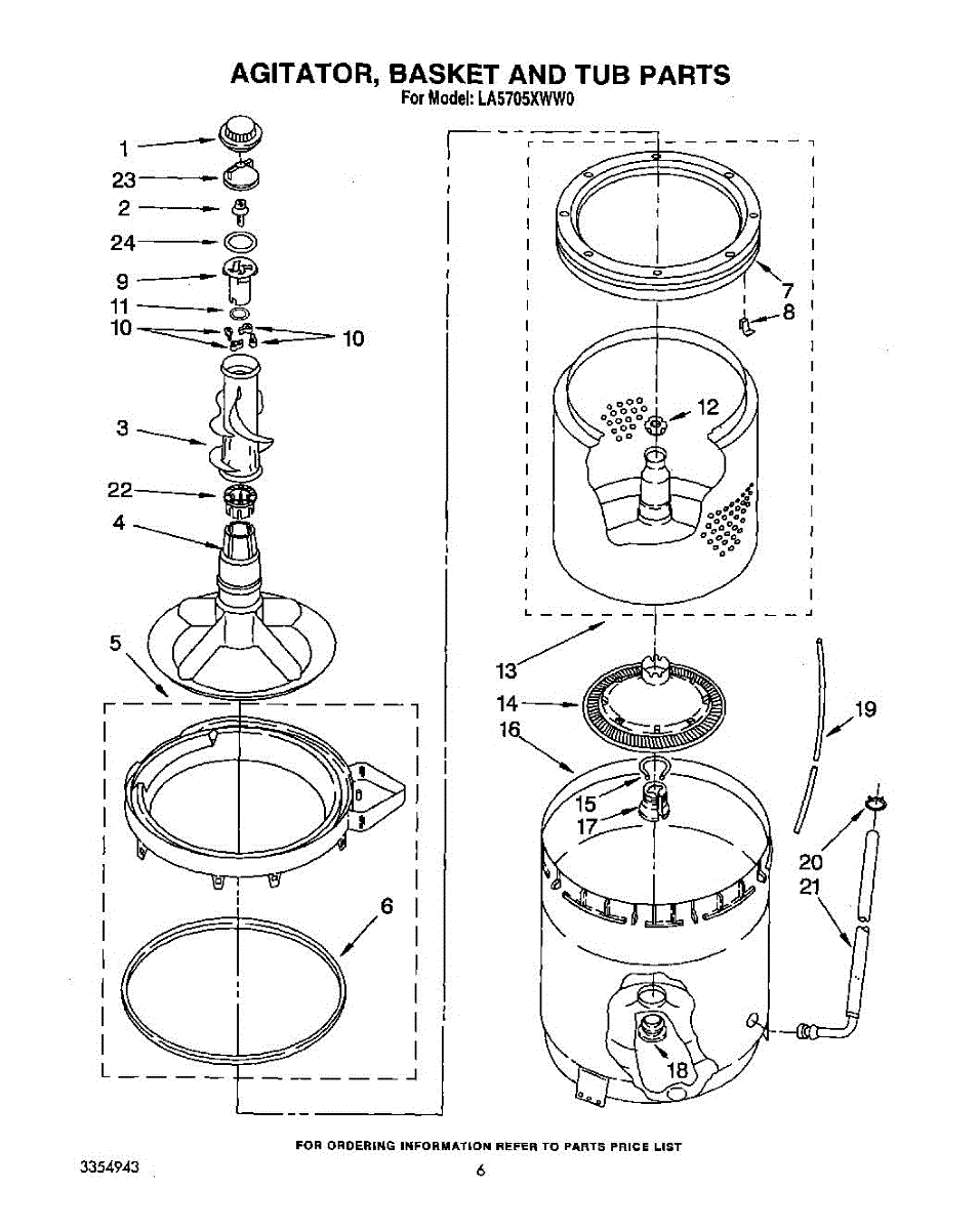

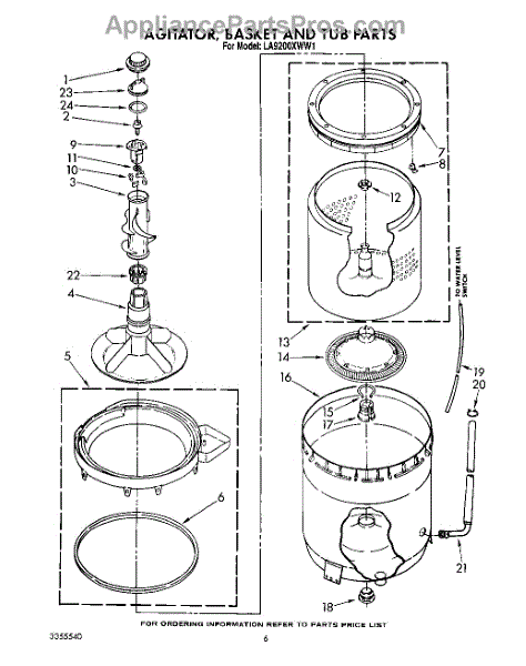

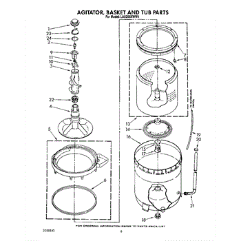

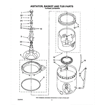

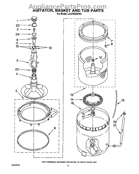

Parts for Whirlpool LA9200XWF1: 05 - Agitator, Basket And Tub Parts
