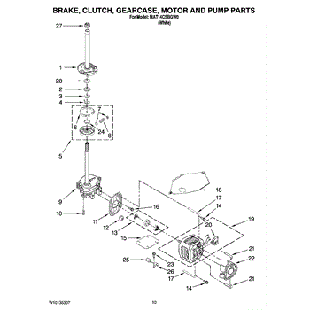

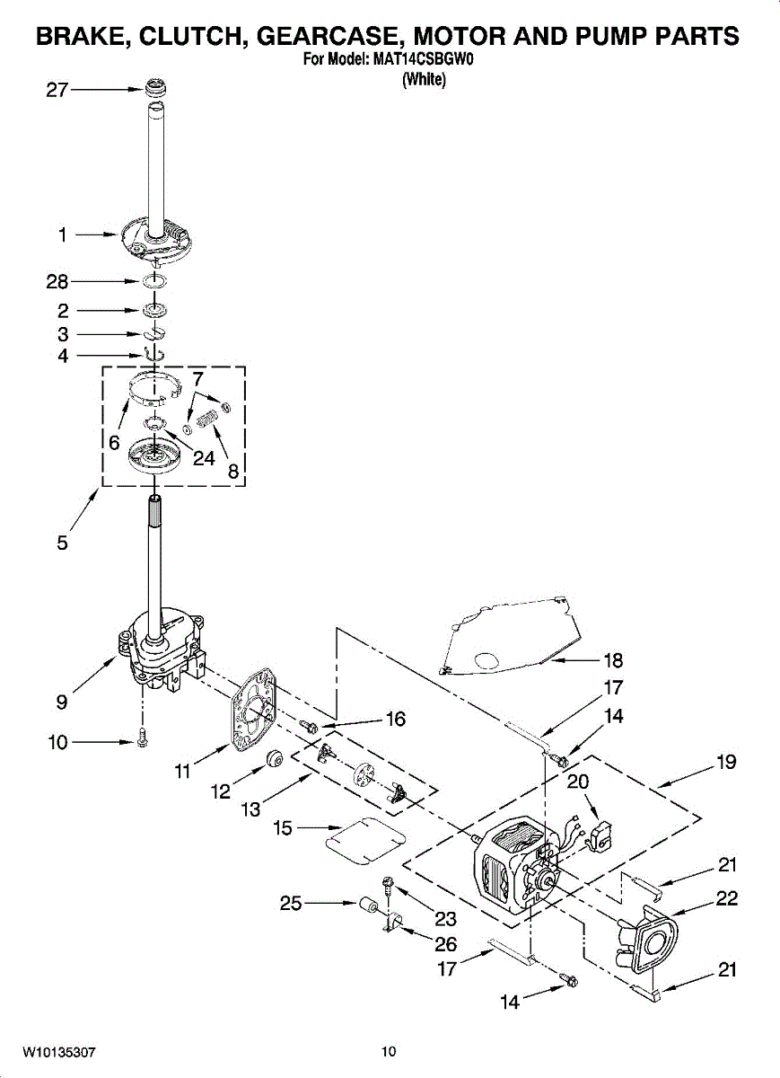

Parts for Maytag MAT14CSBGW0: 06 - Brake, Clutch, Gearcase, Motor And Pump Parts
