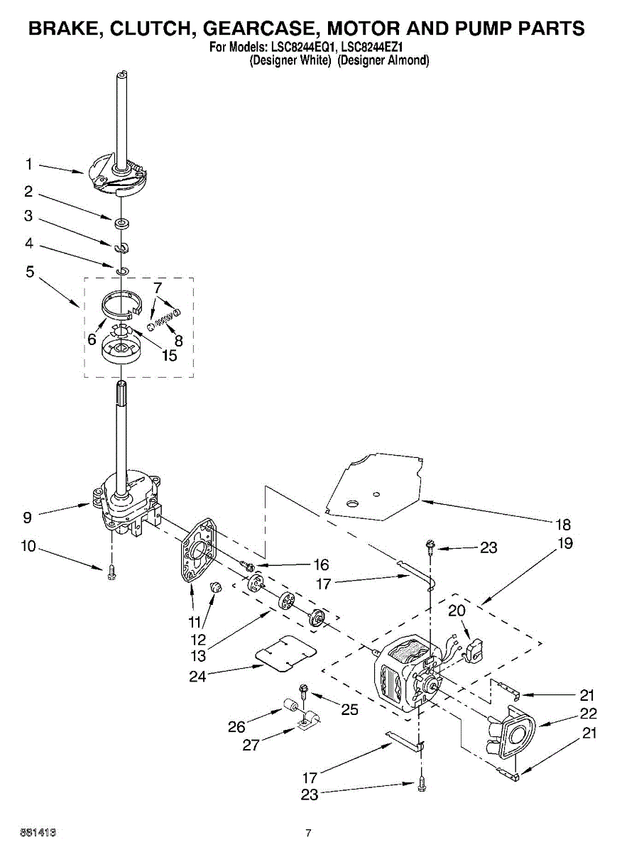

Parts for Whirlpool LSC8244EQ0: 04 - Brake, Clutch, Gearcase, Motor And Pump Parts

The Basket Drive is an OEM replacement part for Whirlpool washers. The basket drive is responsible for rotating the wash basket during the cycle.
Common causes of a bad basket drive include regular wear and tear, mechanical failures, or damage from overloading the washer. These issues can prevent the washer drum from spinning or agitating properly.
Symptoms of a bad basket drive can include:
  • The washer fails to agitate or spin clothes properly
  • Strange noises are heard coming from the drive area
  • The basket no longer rotates smoothly
  • Excessive vibration is noticed

The Spin Tube Thrust Washer is an OEM component for Whirlpool washing machines. It is a washer that fits around the agitator shaft and helps create a seal between the agitator shaft and the aluminum tub. This washer allows the agitator to spin freely during the wash and spin cycles without causing excessive vibration or noise.
Symptoms of a bad spin tube thrust washer include:
  • Noises like banging or clunking coming from the agitator area
  • Shaking or vibrating of the washer tub during spinning
Causes of a bad thrust washer include normal wear and tear after extended use. Exposure to extended periods of unbalanced loads can also put excessive strain on the washer components and lead to premature failure of the thrust washer seal.
This replacement part is also compatible with select Kenmore, Maytag, KitchenAid, and Jenn-Air models.

The Clutch Retaining Clip is an OEM part for Whirlpool washing machines. This clip secures the clutch assembly, which is essential for the proper engagement and operation of the washer's transmission.
Causes of a bad retaining clip can include repeated mechanical stress, corrosion, or accidental damage during maintenance or repair.
Symptoms of a bad retaining clip include:
  • Washer not spinning or agitating properly
  • Excessive vibrations or movement
  • Washer failing to complete cycles correctly

This retainer ring is a genuine OEM replacement part sourced directly from the manufacturer for use on front load washing machines to hold the boot seal in place. The boot seal is the gasket that seals the washing machine when the door is closed to prevent water from leaking. The retainer ring is located flush against the boot seal and has either a spring clamp or screw clamp that secures it. Over time, this ring may become damaged due to the washing machine's normal use and age. If the ring is not tight, the washing machine could leak when in use. If water is coming from the door, it is a good idea to inspect and replace the retainer ring and possibly the boot as well.Unplug the washing machine to prevent electrocution. Remove the front panel, the detergent dispenser, and the kickplate to access the retainer ring. Locate the clamp on the ring and loosen it. Remove the retainer ring and set it to the side. Inspect the boot and then install the new retainer ring. Tighten the clamp and reassemble the washing machine. This retainer ring is sold as an individual unit. It is designed specifically for washing machines manufactured by Whirlpool.
4.9 (655)
The Clutch Assembly is an OEM replacement part for Whirlpool washing machines. It is a component that is responsible for transferring power from the motor to the transmission, allowing the washer tub to spin during the wash and spin cycles.
Symptoms of a bad Clutch Assembly include:
  • The washer tub not spinning or agitating during the wash or spin cycles
  • Loud grinding or screeching noises coming from the washer
  • Excessive vibrations or shaking during the spin cycle
  • The washer failing to start or complete the wash or spin cycles properly
Causes of needing to replace the clutch assembly can include normal wear and tear over time, bearing failure, or physical damage due to impact or overloading.

The Clutch Band and Lining Kit is an OEM part for Whirlpool washing machines. It contains the clutch band and clutch lining components essential for proper transmission of power from the washer motor to its drum during the spin cycle. The clutch band and lining allow for a controlled amount of slippage to safely extract water from clothes without damage.
Symptoms of a bad clutch band and lining include:
  • Excessive noise or vibration during spin
  • Slow or ineffective spinning
  • The drum failing to spin or “locking up”
  • Premature wear of other transmission parts
Over time and with heavy use, these components can wear down. If slipping or damage is detected, it’s important to replace the kit to avoid potential transmission repairs.

This clutch spring cap retains and protects the clutch spring in your washer's drive/clutch assembly, maintaining proper tension. Replacing a worn or missing cap helps the clutch engage smoothly and reduces slipping and noise during spin.
  • Secures the clutch spring within the clutch assembly to prevent movement or dislodging
  • Maintains correct spring preload for consistent clutch engagement
  • Can help reduce clutch slip that appears as weak/no spin, slow spin ramp-up, or intermittent spinning
  • Common signs of trouble: rattling or scraping near the drive, burning smell, or a visibly damaged/missing cap
What's included: 1 clutch spring cap Install notes:
  • Unplug the appliance and shut off water before servicing
  • Access the clutch per your model's service procedure; removing the gearcase/transmission and clutch may be required
  • Carefully relieve spring tension and note the orientation of the spring and cap before removal
  • Inspect the spring, clutch lining, and related hardware; replace any worn components during reassembly

The Transmission is an OEM part for Whirlpool washing machines. This integral component is at the heart of the washing machine's operation, translating the motor's power into action by driving the agitator and spinning the drum.
Regular inspection and maintenance can prolong the life of the transmission, but if these symptoms occur, it may be time to replace this critical component.
Symptoms of a bad Transmission include:
  • The washing machine making unusual noises during the wash or spin cycles, such as grinding or whining sounds.
  • The washer failing to agitate properly, affecting the cleanliness of the laundry.
  • The drum not spinning during the spin cycle, leaving clothes wetter than usual.
  • Leakage of transmission fluid beneath the washing machine.

Motor mount to gear case.

Rubber grommet for motor mount stud.

The Direct Drive Washer Motor Coupling is an OEM replacement part for Whirlpool washers. It is responsible for connecting the motor to the transmission, allowing the washer to agitate and spin the clothes during the wash and spin cycles.
A bad motor coupling can be caused by prolonged use, heavy loads, or overloading the washer. It can also wear out or break over time due to normal usage.
Symptoms of a bad motor coupling include:
  • The washer not agitating or spinning.
  • Unusual noises, such as grinding or rattling, during operation.
  • The motor running but the drum not moving.

This motor retainer secures the motor to its mounting point, keeping the assembly tight and aligned. Replace a worn or broken retainer to cut vibration and noise and to protect nearby seals, wiring, and components. What it does:
  • Holds the motor firmly in place within the assembly
  • Maintains alignment for smooth, quiet operation
  • Supports sealing surfaces and connections; on water-bearing assemblies, help prevent leaks
  • Replace if you notice a loose or rattling motor, new vibration/noise, or signs of movement or leakage at the motor
  • Includes 1 motor retainer.
  • Disconnect power; turn off water supply.
  • Access the motor area and support the motor before removing the old retainer.
  • Inspect mating parts and seals; replace any damaged components.
  • Fully seat the motor and install the new retainer securely; test for abnormal noise or leaks.

The Direct Drive Washer Motor is an OEM part for Whirlpool washing machines This motor drives the agitation, spinning, and draining processes during the laundry cycles, ensuring clothes come out clean and well spun.
Causes of a bad Direct Drive Washer Motor can range from wear and tear over time, overheating due to overloading or obstructed movement, and electrical failures like short circuits or blown capacitors.
Symptoms of a failing Direct Drive Washer Motor include:
  • The washing machine not agitating or spinning correctly
  • A noticeable decline in the washer's performance
  • Unusual noises, such as humming or buzzing, indicating the motor is struggling

The Retainer Clip is an OEM replacement part for Whirlpool direct drive washing machines.
Causes of a bad retainer clip can include wear and fatigue from continuous vibration over many wash cycles. Cracks or breaks in the plastic material may develop as well.
Symptoms of a bad Retainer Clip include:
  • Water leaks detected around the pump area inside machine cabinet
  • Loosening of hoses or tubes interrupting proper drainage flow
  • Potential pump component detachment from disconnected lines
  • Damage to neighboring components submerged by leaked water

The Direct Drive Washer Pump is an OEM part for Whirlpool washing machines. It is responsible for pumping water out of the washer during the drain cycle, ensuring that the washing machine drains efficiently after each wash.
Causes of a bad direct drive washer pump can include blockages from debris or foreign objects, wear and tear from regular use, damage to the pump impeller, or electrical issues affecting the pump motor. Over time, these factors can hinder the pump's performance, leading to operational issues.
Symptoms of a bad direct drive washer pump include:
  • Washer not draining water properly
  • Unusual noises during the drain cycle, such as grinding or humming
  • Water leaks from the bottom of the washer
  • Washing machine stopping mid-cycle due to drainage issues
Related item: Motor coupling 285753A.
