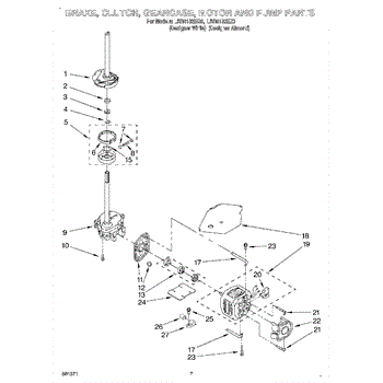

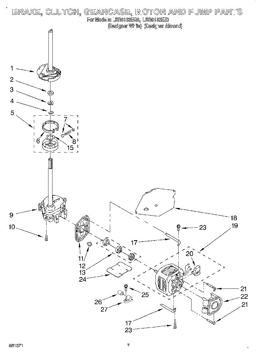

Parts for Whirlpool LSR6132EZ0: 04 - Brake, Clutch, Gearcase, Motor And Pump Parts
