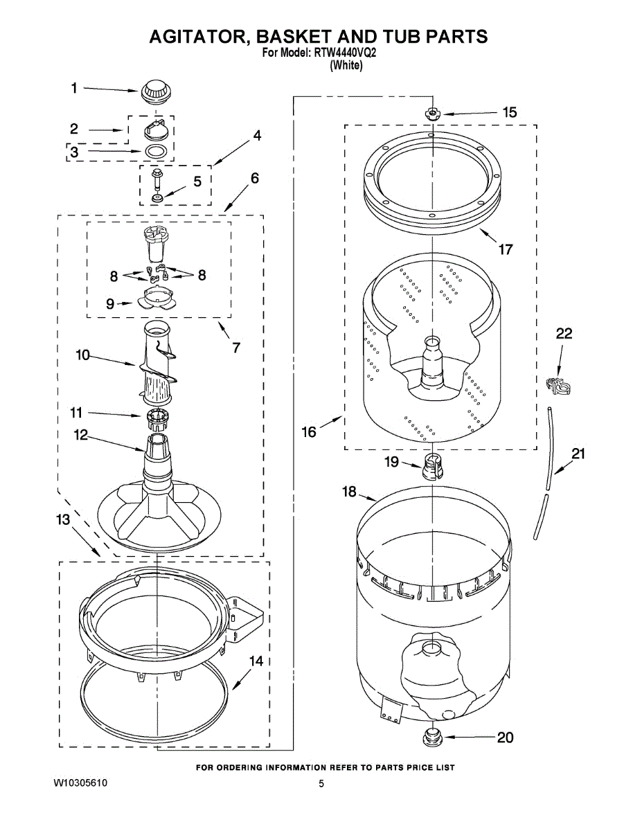

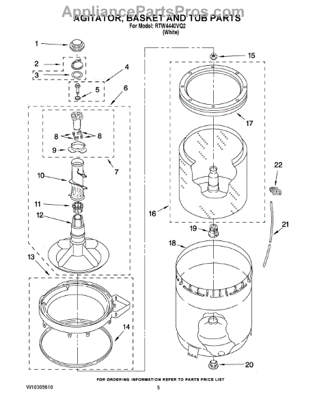

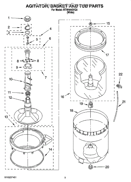

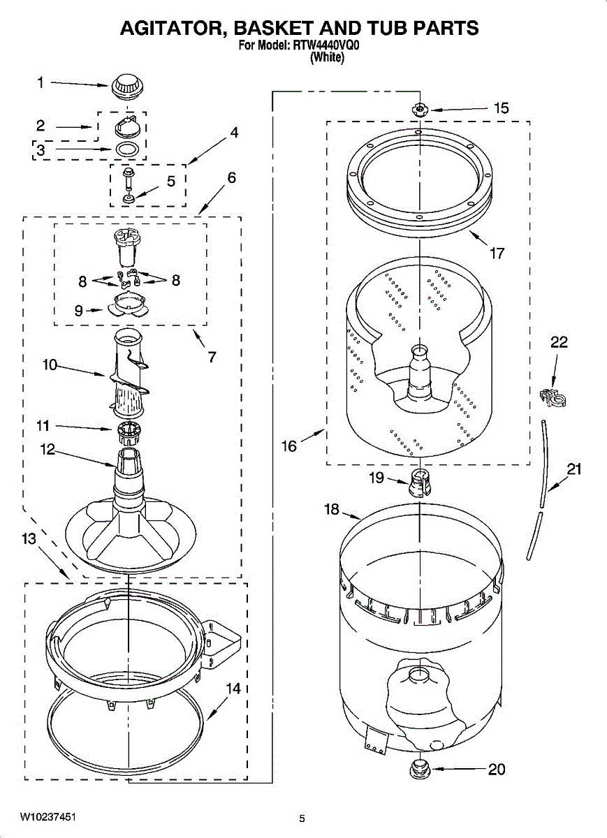

Parts for Roper RTW4440VQ0: 03 - Agitator, Basket And Tub Parts
